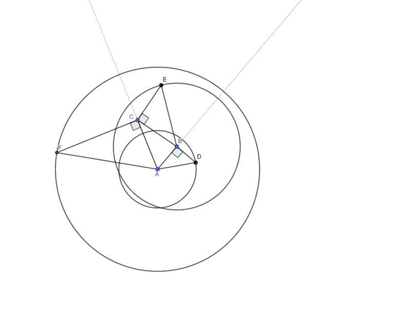

I model the twin paradox with a straightedge and a compass.
To do this, I take the nonchalant trope that "the formula of the spacetime interval is like the formula of the Pythagorean theorem but with a minus sign" literally.
This is a response to a recent insight article regarding the twin paradox. The idea is to model the most basic scenario in a way, that the paradox disappears. This basic scenario and its kinematic effects are then modeled using only a straightedge and a compass.
The best way to read this post is to have a pen, paper, a compass, and a straightedge ready. Alternatively, the construction can be done in programs such as GeoGebra. The geometrically minded may also do the geometry in their head. For those with little geometric imagination, I provide a complete drawing at the end of the post that you can use for reference. However, I encourage you to really "do the geometry".
Before I model the twin paradox, I first strip the scenario of all elements that are usually part of the narrative. This includes the story of two twins, that are separated and reunited having aged differently. Secondly, I remove all references to observations (i.e. that one of the twins sees the other twin). Next, I remove all technical gimmicks such as rocket ships or telescopes that are used to flesh out the story. I will also remove something that might be unsuspicious of adding confusion: coordinate systems, coordinates, and frames of reference. Instead, I will model a spatial geometry on which observers who are embedded in this geometry must apply their relativistic coordinate systems. Lastly, I will remove the paradox from the title of the scenario: Instead of Twin Paradox, I name it the “three inertial particles scenario”.
In this scenario, I consider three particles ##P_1##, ##P_2##, and ##P_3## at three distinct events ##A##, ##B##, and ##C##. The events take place in a space without significant gravitational effects. For this model, an event is the coincidence of two particles in one place. To be in one place means, that two particles collide or pass each other very close. In this model, every event creates an electromagnetic signal. A signal propagates outward from the location of the event at constant speed in all directions. The three events are time-like related. This is what happens at and between the events:

If you decide to try and draw your own model, I give you three hints:
1) The idea is not to draw a Minkowski spacetime diagram.
2) The model requires only one drawing.
3) Since the three points are always coplanar, I can restrict the model to a plane without losing any relevant degree of freedom.
This is how I model:
I mark a point ##A## on the plane. From this point, I draw two rays ##b## and ##c## in arbitrary directions. Point ##A## marks the location where the particles ##P_1## and ##P_3## coincide (i.e. the event A). The two rays mark the directions of the particles ##P_1## and ##P_3## after event ##A## has taken place.
Next, I mark a second point ##B## that lies on one of the ray ##b##. This point marks where the particles ##P_1## and ##P_2## coincide (i.e. the event ##B##). The distance ##AB## is the spatial separation between events ##A## and ##B##.
In the next step, I model the temporal separation between the events. This temporal separation literally answers the question: How long after event ##A## does event ##B## take place? For this, I draw a circle ##c_1## around point ##A##. The radius ##r_1## of this circle must be greater than the distance between points ##A## and ##B## (i.e. ##r_1 > AB##). This circle signifies how far the electromagnetic signal emitted in the event ##A## propagates while the particle ##P_1## moves from ##A## to ##B##. If the radius of the circle is much larger than the distance ##AB##, the particle ##P_1## moves much slower than the signal propagates. The smaller the radius, the faster the particle moves. The speed of the particle can be expressed as ##v_1=AB \div r_1##. It should be noted, that this “speed” is a dimensionless ratio: The numerator (i.e. the distance ##AB##) and the denominator (i.e. ##r_1##) of the ratio are both distances.
After modeling the spatial and temporal separation, I can determine how much proper time ##t_1## the particle ##P_1## experiences as it moves from ##A## to ##B##: I apply the two distances ##AB## and ##r_1## to the formula of the spacetime interval:
$$\Delta s^2 =\Delta t^2 - \Delta x^2$$
Because the events ##A## and ##B## are time like related, I can plug in ##s = t_1##, ##\Delta t = r_1 ## and ##\Delta x = AB##. If I draw the square root, I get
$$t_1 =\sqrt{(r_1)^2 - (AB)^2}$$
The question is: Which distance or distances in the drawing represent (the square root of) the spacetime interval? If you don't see it immediately take your time. Draw some line segments. I will point it out in the next step. But once I tell it to you, the relation becomes obvious. Then the possibility for your own "aha moment" is gone.
To represent ##t_1## I draw a line segment that starts in point ##B## and that is perpendicular to the line segment ##AB##. The endpoint of this line segment lies on the circumference of the circle ##c_1##. It is not important to which side I draw this line segment. For reference, I will name the point where the line segment touches the circle ##c_1## point ##D##. I now have a right-angled triangle ##ABD##. The side ##AB## is the distance between the locations at which the two events take place. The side ##AD## of this triangle is the radius of the circle i.e. ##r_1## the distance the signal has propagated. This side ##AD## is obviously the hypothenuse of the triangle! The side ##BD## is the side for which the formula of the spacetime interval applies.
It is important to note, that the point ##D## and the line segments ##AD## and ##BD## have no spatial significance. Nothing moves along those line segments, nothing happens at point ##D##. The lengths of the line segments abstractly represent physical quantities: The line segment ##AD## represents the distance the signal has propagated (in all directions not only along the line segment). The length of the line segment ##BD## is proportional to the proper time that can be read of a clock moving with particle ##P_1##. I.e. ##BD = t_1##.
If the distance ##AB## is one light second, then ##t_1 = (BD \div AB) seconds##.
I can now repeat the same procedure for the particle ##P_2## and the interval ##BC##: First, I mark a point ##C##, that lies on the second ray ##c##. This point ##C## marks where the particle ##P_2## and ##P_3## coincide. I can connect points ##B## and ##C## with a line segment to visualize the trajectory of the particle ##P_2##. Next, I draw a circle ##c_2## with a radius ##r_2 > BC## around the point ##B##. I draw a line segment from point ##C##, that is perpendicular to ##BC## and that ends on the circumference of the circle ##c_2##. I name the point where the line segment and the circle meet ##E##. I have again a rightangled triangle ##BCE## The distance ##CE## represents the proper time ##t_2## that the particle ##P_2## experiences between the two events ##B## and ##C##.
The question is now: How much proper time ##t_3## does the particle ##P_3## experience between the two events ##A## and ##C##? The time that the particle experiences depends on the distance ##AC## and on the distance the electromagnetic signal from the event ##A## has propagated as the event ##C## takes place.
I know that the signal from the event ##A## propagates the distance ##AD## while the particle ##P_1## moves from ##A## to ##B##. After event ##B## the signal propagates the distance ##BE##, while the particle ##P_2## moves from ##B## to ##C##. So, I can conclude, that between the events ##A## and ##C##, the signal from event ##A## propagates a total distance of ##AD + BE##. Consequently, I draw a circle around the point ##A## with a radius ##r_3 = AD + BE##. Next, I draw a line segment that starts in point ##C##, that is perpendicular to ##AC## and that ends on the circumference of the circle ##c_3##. I name this point ##F##. I have again a right-angled triangle ACF. The distance ##CF## expresses the proper time ##t_3##, the particle ##P_3## experiences between the events ##A## and ##C##.
You can create different variations of this model and see, how the proper times ##t_1 + t_2## (i.e. ##BD + CE##) and ##t_3## (i.e. ##CF##) relate to each other.
If I assign a numerical value to ##t_1##, I can calculate ##t_2##, ##t_3## and the distances.

Drawing of the three particle scenario as described above:
Basic GeoGebra model: https://www.geogebra.org/classic/u99bxf5p
Animated https://www.geogebra.org/classic/pzgjv6qv

If so, your "response" is an unnecessarily long-winded attempt to describe the "spacetime geometry" viewpoint described in that article. You are constructing the same triangle in spacetime that the standard scenario constructs (in the idealized limit of an instantaneous turnaround).
Unfortunately, your attempt obfuscates the actual spacetime geometry because it uses Euclidean geometry, whereas the geometry of spacetime is Minkowskian. The straightedge for making lines is all right, but the compass is wrong; for Minkowskian geometry it should be a tool that draws hyperbolas about a given center, not circles. For this particular scenario, you can get away with it because moving a term from one side of the equation to the other makes it look like the ordinary Pythagorean theorem. But this method will not generalize to other scenarios; whereas the "spacetime geometry" viewpoint described in the Insights article works for any scenario whatever, in full generality.
