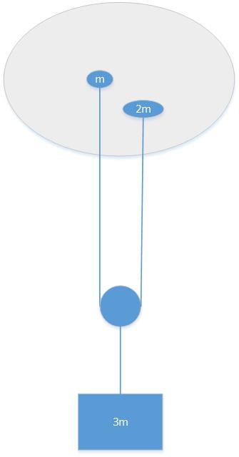

Q) Two particles of masses m and 2m are placed on a smooth horizontal table. A string,
which joins them, hang over the edge supporting a light pulley,
which carries a mass 3m
Two parts of the string on the table are parallel and
perpendicular to the edge of the table. The parts of the string
outside the table are vertical. Show that the acceleration of the
particle of mass 3m is 9g/17.

Suppose the two masses on the table are each distance z from the edge.
The string runs from one, to the edge of the table, then down a distance y, under the pulley from which the mass 3m hangs, back up to the table and along to the other mass.
What is the total length of the string?
Now one mass moves distance x towards the edge. The mass 3m is now distance y' below. What is the total length of the string now?

I had quite a bit of difficulty picturing this arrangement. The wording is poor and the scenario is, strictly speaking, impossible. [Some of that assessment may be "sour grapes" on my part]
Apparently the bits of string leading away from the masses are nearly parallel to each other and exactly perpendicular to the edge. Or exactly parallel to each other and nearly perpendicular to the edge.
In any case, the places where the two segments hang over the edge are close to one another, separated by the width of the pulley below.
I assumed the table to be rectangular. Doesn't that make it more reasonable?

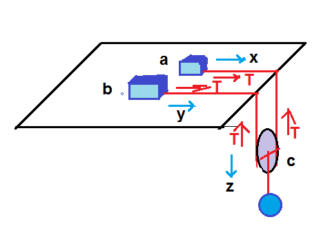

See the picture, it makes you imagine the situation easier. Assume mass a displaces to the right by x, mass b displaces to to the right by y. As the length of the string is constant, the vertical path becomes longer by x+y. As the parts of the string between the edge of the table and the edge of the pulley are equal, the pulley (and mass c) moves down by z=(x+y)/2. The accelerations are double derivative of the displacements...
245659
Likes Doc Al and Rishabh Narula
nice i get it now.the vertical path gets increased to x+y but it happens through two equal string parts.so each string part goes down by x+y/2...i.e so do pulley and mass 3m.thanks.
It is (x+y)/2. Do not forget the parentheses.
