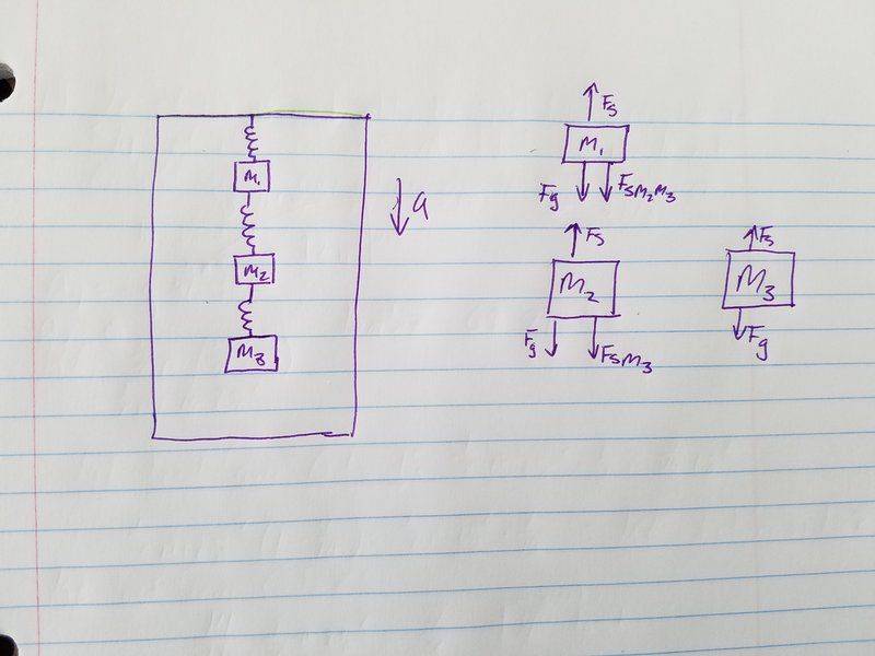

Three masses (m1=3.2, m2=9.6, and m3=6.4) hang from three identical springs in a elevator with a spring constant of 349N/m. The elevator is moving downwards at -3.7m/s and accelerating downwards at
a= -2.5m/s^2.
What is the magnitude of the net force on the middle mass?
Force(spring)=-kx
F-mg= -ma
F= mg-ma
I tried 9.6(9.81-2.5) and got 70.176 but that is wrong.
So I tried (9.6+6.4)X(9.81-2.5)= 116.96 but that is also wrong.
What am I doing wrong?

Oh, I misunderstood the problem. You need to post a diagram of the setup please. Use the UPLOAD button in the lower right up upload a PDF or JPG of the setup. Thanks. Also, if you could show your FBD for each of the 3 masses on that diagram, it would be a help.
I'm unsure of my FBD for each of the masses but this is what I drew.
Do we know the acceleration of the middle block?
Do we know the mass of the middle block?
What is the unknown that we want to calculate?
Is there an equation that relates those three quantities?

I tried the acceleration times the middle mass and that was wrong.
F=ma
(9.6kg)(-2.5m/s^2)= -24 N
F=ma
That answer is correct.
Thank you, turns out the program wanted positive 24 N.
