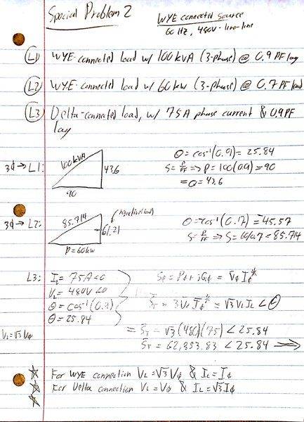

In summary: I don't understand. I thought we were just squaring everything to get rid of the j correct?In summary, the instructor solutions use equations to solve the homework problem, and the student solutions use the power triangle. The student solution is not solving for Qcap, but for Qnew - Qold. When the substitute for Qnew is used, the student solution gets rid of the j correctly, but there is a weird sign problem in the second line.

Power Triangle and 3-phase equations (listed in my solutions)

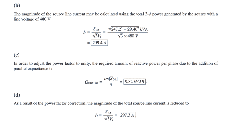

Here are the instructor solutions:
The instructor solutions just go straight into using equations, but I like to use the power triangle because it is more intuitive for me. The problem is I am not sure what I am doing wrong in my work... The first power triangle for load one looks to match the first chunk ( 100(0.9 +jsin(25.84)) of work in the instructor solutions, but then I get stuck at the second one. I don't see what I am doing wrong and I don't get what the instructor solutions are doing...
Your second load is a leading one instead of a lagging one. Your power triangle looks OK except that the leading load results in a negative value for the reactive load (vertical component).
Right I caught that mistake so I made my Q for load 2 negative, but I didn't redraw my power triangle. I still get the wrong answer though. My solution above uses a negative Q for load 2.
I think I see the problem.
On L3, its a delta load. So if you just know the line current and the phase to phase voltage, the single phase kVA is given by kVph-ph * Iline. To get the three phase kVA, just multiply by 3, or 3*kVph-ph*Iline.
Ya I figured out my mistake and got that same equation like you have. The voltage we we're given was line to line, but the current for L3 was a phase current so I had to change it to a line current by using iL=sqrt(3)i_phasor. so that and the original equation for S gave me the right answer. Thanks!

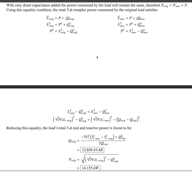

Here are the solutions for that problem:
In my solution I had the exact same start. Trying to set up 2 equations and then use substitution and etc. But what I don't understand is what happens in the solutions when they are squaring everything. Firstly, the reason we want to square is to get rid of the j correct? but j^2 = -1. Why don't they have a negative in their answer in the second line?
Edit* Also, when the substitute for Qnew... They write Qnew = Qold - Qcap, but that does not seem right... The equation for caps we have been using this whole time is Qcap = Qnew - Qold which means Qnew is Qcap+Qold. There seems to be a lot of weird sign things happening here and I don't understand why
