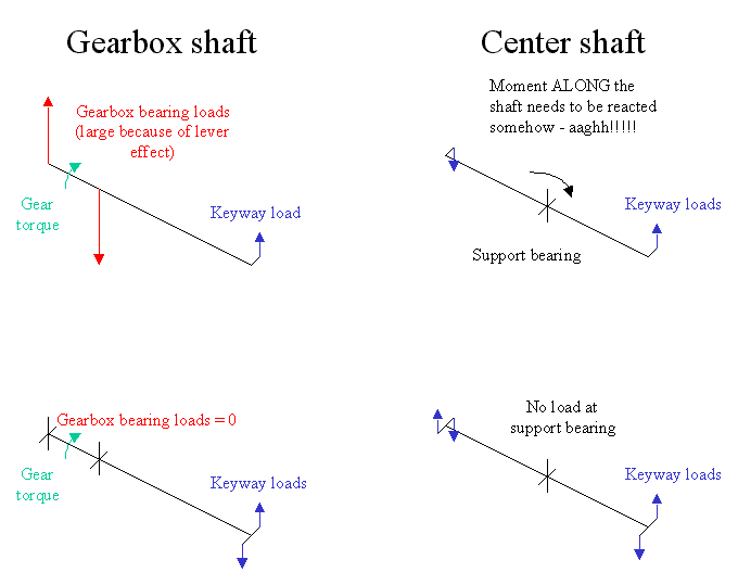

Torque in the shaft = 150 * 550 * (60/2pi) / 1500 = 525 ft lb.
If this is a fairly small diameter shaft, applying a few tons of force just at one side could be a problem in terms of bending the shaft. I would be happier applying the torque load at several points round the circumference (3 points minimum) so (in theory at least!) it won't bend.
You kinda lost me there, Aleph. I can see it wanting to twist if it's telescoped out enough, but where would the bending force come from?
If I understaod what you were proposing correctly:
Imagine the shaft is a circular section beam fixed at one end. You are applying a force to the other end, from the keyway, just at one point on the circumference. That is both twisting and bending the beam.
It also puts a reaction force and moment on the "fixed" end of the beam. For a shaft in bearings, that will be taken out as rotating radial loads on the bearings (of similar size to the force providing the torque - i.e. a few tons, a lot bigger than the loads you would get from "normal" unbalance in the shaft.
If you put two keyways on opposite sides, you apply two forces in opposite directions. That gives twist but no bending, and no radial load at the gearbox end.
I would prefer more than two keyways (or splines), but possibly for irrational reasons in this context. The dynamics of "two bladed" rotating structures (propellors, helicopter rotors, etc) is a lot more complicated than for more that two blades, my instinctive reaction to that situation is "not doing it at all is simpler than working out what might happen if you have to do it".
Okay, I think that I see what you're talking about. Wouldn't that tendency to bend, however, be negated by the circumferential support of the outer sleeve and centre bearing?
I was assuming the only contact between the shafts would be where the drive was taking place. I didn't think about the center shaft till your last question, but that also has a big problem with one keyway - see the attached free body diagrams.
I guess the only way it would work with one keyway was if the shafts DID support each other somehow - but personally I would still prefer killing off all these issues with a "proper" set of splines.

I'm afraid that I don't understand free-body diagrams. I never even heard of one until I joined PF, and then Fred was kind enough to explain the idea to me by PM. I could probably make one if I knew what I was starting with, but I can't interpret one that somebody else makes. :redface:
I totally agree that somewhere in the vicinity of 16-23 splines would be appropriate; I was just trying to look for the low-dollar alternatives. It really makes a big difference if this is to be a single-purpose personal project or a prototype for something that is intended to be patented for mass production. As a fairly economical compromise, 4 splines might deal with our mutual concerns.
"Free body diagram " is just a fancy name for a picture showing all the forces acting on an object. The important thing is being consistent about showing the forces acting ON the object, not the equal-and-opposite reactions, so it's clear how the forces balance, (or "are in equilibrium", to use more fancy words).
Yeah, that's how Fred explained it to me. Yours doesn't look even remotely like one that I would do, though. Apparently I misunderstood when he was telling me what is involved. I would have a more 'pictoral' approach, so that what's what is more apparent; I can't make heads nor tails of yours, despite the labels. I'm not faulting your diagram, only my ignorance of such things.
