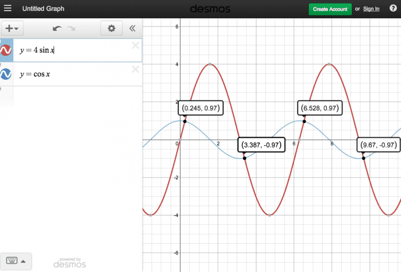

As far as I know there isn't any way to solve that algebraically. The only way I could think of to solve for A might be graphing the functions f(x)=4sinA and g(x)=cosA and maybe use one of the solutions to find the angle where the two thrust components are equal. Below are the two functions graphed and some of their solutions.
So, assuming I'm on the right track, where do I go from here? I initially thought the x-value of each solution would be a possible motor angle, but if you plug that back into the equation above the two sides aren't equal. So how on Earth would I do this?

As long as you have the same angle A on both sides of the equation, carry the trigonometry forward a little bit:
4 sin (A) = cos (A)
##\frac{sin (A)}{cos (A)} = tan (A) = \frac{1}{4}##
##tan^{-1} (A) = A = tan^{-1} (\frac{1}{4}) ≈ 14° ##
where tan-1 is the arctangent function.
