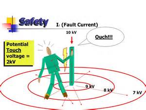

Last thing
when lightning strikes your camper there will be kiloamps flowing through it. They flow into the Earth and spread out from there.
So there is a potential gradient radiating out from the point of entry to earth.
I believe that's why tropical wading birds sleep standing on one leg.
You get the idea - take short steps or stay indoors during lightning storms. Don't stand on the ground with one hand leaning on the trailer.
