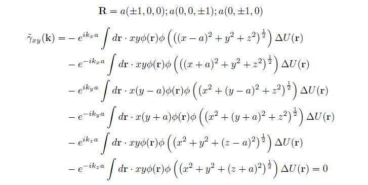

Know another question appers..
In simple cubic crystal for the first 6 nearest-neighbor;
[tex]\gamma_{ij}(R)=- \int d\vec{r} \psi^{*}_{i}(\vec{r})\psi_{j}(\vec{r}-\vec{R}) \Delta U(\vec{r})[/tex]
must be diagonal.
I made some calculations for [tex]\gamma_{xy}[/tex] in attached the document.
Is it diagonal for the same reason?
