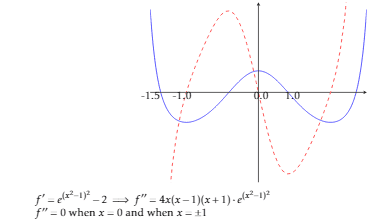

ok I tried to tikz graph of e^{x^2-1)^2 -2 just borrowed an example online but this isn't what I want
the domain and range should be equal and want the normal xy axis not a box with tics only at the zeros
$$\begin{axis}
\addplot[
draw = blue,
domain=-2:2,
range=-2:2,
samples=50
] {exp(x^2-1)^2};
\end{axis}
\end{tikzpicture}$$
sorry thot it would render here?
The picture should begin a begin tikzpicture marker.
And dollars should not be used around the picture. It is not a math formula after all.
Since we want to use the package pgfplots, we need load it in the preamble with a [M]%preamble[/M] directive.
You can see examples in the Live TikZ Editor, which you can activate from the MHB Widgets visible at the right when posting.
The result is:

Use [M]ymax[/M] to set the range of the y-axis as a property of the [M]axis[/M].
Use [M]axis lines=middle[/M] to get normal axis lines.
And while we're at it, let's add [M]grid=both[/M] for some nice grid lines. ;)

If you want, you can also add [M]xmin[/M] and [M]xmax[/M] to control the range of the x-axis.
Oh, and it looks as if you actual want a different formula than [M]exp(x^2-1)^2[/M].
Ah well, we can replace it with [M](exp(x^2-1))^2 - 2[/M] or [M]exp((x^2-1)^2) - 2[/M] depending on which one you wanted. (Thinking)

I tried to add the second derivative graph also on this graph
but it returned operater unknow but I tried exp also and :confused:
$f'' = 4x(x-1)(x+1) \cdot e^{(x^2-1)^2}$the problem is about where it is concave so need f''
so did this but gave it a c-
not sure why the tikx code didn't render here so this is an image form overleaf
$f'=e^{(x^2-1)^2}-2 \implies f'' = 4x(x-1)(x+1) \cdot e^{(x^2-1)^2}$
$f''=0$ when $x=0$ and when $x=\pm 1$

That is actually the first derivative of $f$.
That is, it is $f'$.
Anyway, it works for me:
\begin{tikzpicture}
%preamble \usepackage{pgfplots}
\begin{axis}[xmin=-1.8, xmax=1.8, ymin=-3, ymax=3, axis lines=middle, ticks=none]
\addplot[
draw = blue, smooth, ultra thick,
domain=-1.5:1.5,
] {exp((x^2-1)^2)-2};
\addplot[
draw=red, smooth, ultra thick, dashed,
domain=-1.5:1.5,
smooth
] {4*x*(x-1)*(x+1)*exp((x^2-1)^2)}
foreach \x in {-1,0,1} { (axis cs:{\x},0) node[below right] {\x} };
\end{axis}
\end{tikzpicture}
