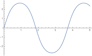

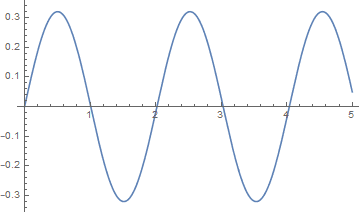

So I threw this into Mathematica to see what it says. I used the non-approximate differential equation:
$$\ddot \theta + \frac{g}{L} \sin(\theta) = 0$$ and the equation for the tension $$T=mg \cos(\theta)+ m (L \dot \theta)^2/L$$
I solved the differential equation with Mathematica and got $$\theta(t)=2 \text{am}\left(\frac{\dot \theta_0 t}{2},\frac{4g}{\dot \theta_0^2 L}\right)$$ where ##\theta (0)=0## and ##\dot \theta(0)=\dot \theta_0## and where ##\text{am}## is the Jacobi Amplitude function. I found it easier to parameterize by measuring ##t=0## when ##\theta=0## so that I could easily find the period using the "FindRoot" function. I used FindRoot to find ##t_f##, the time that the first period ends. Then I calculate the normalized average tension by $$\bar T = \frac{1}{mg t_f}\int_0^{t_f} |T| dt$$
In all of the below I used ##g=9.8## and ##L=m=1## and I varied ##\dot \theta_0##.
For ##\dot \theta_0=1## we see a nice approximately simple harmonic motion, with a period of ##t_f=2.02## and ##\bar T = 1.025##
For ##\dot \theta_0=6.1## we clearly see the expected noticeable deviation from simple harmonic motion, with a period of ##t_f=3.71## and ##\bar T = 1.606##

I also got 1.07 for ##\dot \theta_0=1.620## which gets pretty close to 30 deg peak

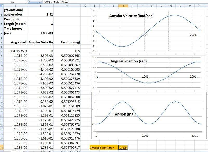

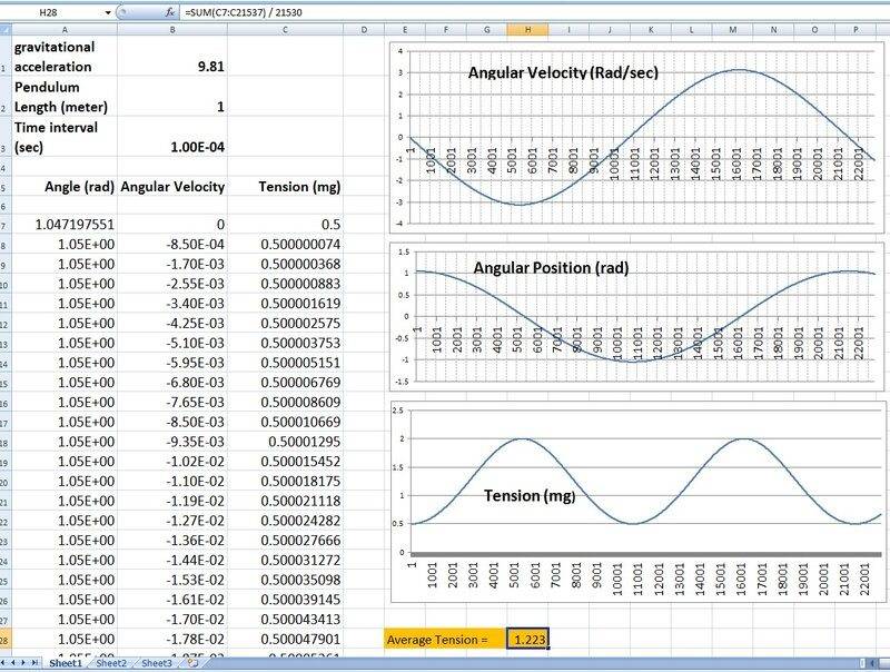

I tried to use a spreadsheet for numerical analysis. A total of 20,000 calculation steps were used, but my computer only took less than a second to complete the calculation.
When the maximum angle is 60 degrees, I found that the average tension is 1.223 mg, which is greater than 1.

Because I haven't used this kind of numerical analysis for a long time, there are many imperfections in the calculations I uploaded before.
By averaging only a quarter period and other optimization measures, I now improve the efficiency of the calculation method, as shown below
1. The time interval can be increased from 0.1 ms to 1.0 ms
2. The number of iterations dropped sharply from 20000 to only about 1000
Please note that the calculation result only increased from 1.223 to 1.224, with an error of less than 0.1%, which really surprised me.
I used the second-order Runge–Kutta method, if anyone is interested, you can refer to this link

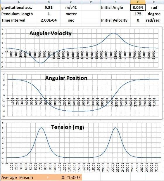

I have a thought in my mind, that is, when the initial angle is greater than 90 degrees, whether the average tension will always be less than 1mg. After some effort, if there is no error in my calculation, I finally found that for example, the initial angle is 175 degrees, the average tension will be much less than 1mg. I believe that when the angle is closer to 180 degrees, the average tension may even gradually approach zero.
By the way, I am considering the practical application of the calculation of this tension time average. One of the possible applications is that the probability of deformation and breaking or the service life of the rigid inflexible rod of the pendulum is proportional to the average tension. But I don't know if I should use the time average of absolute values in this case.
