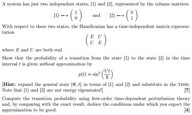

The problem consists of 2 parts,the first one(I have done it) is on the following website:
https://www.physicsforums.com/threads/transition-probability-from-two-states.804343/
Q1: I calculated the desired result p(t) = sin^2(Ut/h). However,I don't understand why <1,t | 2 > will give the coefficient corresponds to the transition probability from state 1 to state 2 in Time t. My initial guess is similar to that of OP in the above post, but take the scalar product of the general state with |2> .

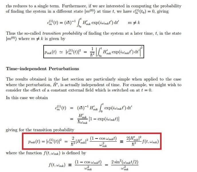

In the second part,I was asked to compute the transition probability using 1st-order time-dependent perturbation theory.Using the result from my notes:
where P_mk means the transition probability from energy eigenstate k to m at time t.
H'_mk = < m(0) | H' | k(0) > , where H' denotes the perturbation.
w_mk = w_m - w_k = ( E_m - E_k )/ h
Q2: I was a bit confused when I calculate H'_mk. Using the definition of scalar product in matrix
representation, I have H'_21 = < u_2 | H' | u_1> , where |u_i> is defined as in the above post.
However,(1 -1)(E U U E) (1 1)(forgive me for the matrix notation...) is 0 since |u_1> and |u_2>
are orthogonal. So the P_21 (t) vanishes which is not the thing I want.
Interestingly, if instead, I take the state m and k to be |2> and |1> respectively, I would have
(0 1)(E U U E) (1 0) = U ,and following the formula I found that P_21 (t) = sin^2(Ut/h)
However,(0 1) and (1 0) are NOT energy eigenstates,but H'_mk works with energy eigenstate.Why would they produce the desired result?
This is basically Born's rule. The probability of finding the system described by ##| \psi \rangle## in state ##| \phi \rangle## is given by ##\left| \langle \phi | \psi \rangle \right|^2##. Since the system is initially in state ##| 1 \rangle##, i.e., ##| \psi (t=0) \rangle = | 1 \rangle##, calculating ##\left| \langle 2 | \psi (t) \rangle \right|^2## will give the transition probability from ##| 1 \rangle## to ##| 2 \rangle## as a function of time.

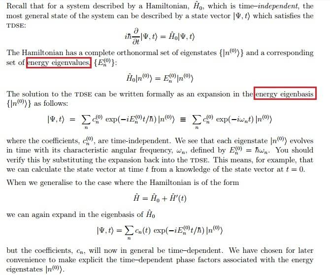

2.Below is the first page of my notes(the derivation of time-dependent perturbation)
 Notice the red boxes,everything used in the derivation is the energy eigenstates.I don't understand why |1> and |2> are related to the context.
|1> and |2> actually represents the spin-up and spin-down ,so I think there is nothing to do with energy..?

What you showed is that if the system is in state ##|u_1 \rangle## or ##|u_2 \rangle##, which are eigenstates of the Hamiltonian, then the system will stay forever in those states, which is what you would expect for a time-independent Hamiltonian.
This is all fine in the abstract Dirac notation. But when you go to matrix-vector notation, you have to make a choice of basis. In the problem, it is stated the basis used is ##|1\rangle \rightarrow (1, 0)^T## and ##|2\rangle \rightarrow (0, 1)^T ##. It is in that basis that
\hat{H} \rightarrow \begin{pmatrix} E & U \\ U & E \end{pmatrix}
such that the matrix elements ##H_{1,2} = H_{2,1} = U##.
Note that in terms of the notes you have posted, ##|1 \rangle## and ##|2 \rangle## are eigenstates of ##\hat{H}_0##,
\hat{H}_0 \rightarrow \begin{pmatrix} E & 0 \\ 0 & E \end{pmatrix}
and the coupling is given by
\hat{H}' \rightarrow \begin{pmatrix} 0 & U \\ U & 0 \end{pmatrix}
So you are working with eigenstates of the base Hamiltonian ##\hat{H}_0##.

My last question: Can you explain why can we decompose the matrix as H_0 and H' as you have shown?
And if H' = ( 0 U U 0) instead of ( E U U E) , then H'_21 = (0 1) (0 U U 0) (1 0) = (U) ?
You have that ##\hat{H} = \hat{H}_0 + \hat{H}'##, so you can decompose it any way you want, so long as both ##\hat{H}_0## and ##\hat{H}'## are hermitian. The most natural approach is to take ##\hat{H}_0## to be the diagonal, and ##\hat{H}'## to something that only induces couplings between the eigenstates of ##\hat{H}_0##. (Most often, ##\hat{H}_0## describes the base system and ##\hat{H}'## an external factor).
Yes. But note that you are mixing two approaches. Given the basis set ##\left\{ | \phi_i \rangle \right\}##, the state of the system in vector notation is given by
| \psi \rangle \rightarrow \begin{pmatrix} \langle \phi_1 | \psi \rangle \\ \langle \phi_2 | \psi \rangle \\ \vdots \end{pmatrix}
and any operator ##\hat{A}## is described by a matrix ##\mathbf{A}##, with elements obtained as ##A_{i,j} = \langle \phi_i | \hat{A} | \phi_j \rangle##.
If you are given matrix ##\mathbf{A}##, then you can simply find the elements ##A_{i,j}## by reading them off the matrix.
