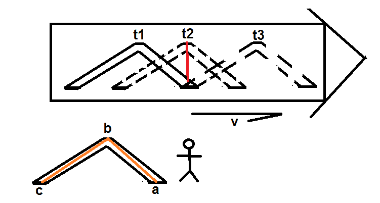

Hi
Couldnt figure this out
U have 2 identical clocks where a pulse of light goes from a light source (a), reflects off a mirror (b) and goes to the end (c)
A person is stationary wrt one clock and another clock is in a spaceship moving, relative to the observer, in the direction v at velocity v
The clock in the spaceship is shown at time t1, t2 and t3
Theory says the observer should see the clock in the spaceship ticking slower than the clock at rest wrt the observer.
If the height of the clock is H and its length is L the observer will deduce the clock in the spaceship ticks at 2H/c. The observer will deduce the stationary clock will tick at some time greater than 2H/c ...is that right?

You can't make a clock with a pendulum that swings one way and then stops. So that isn't a clock, unless you put a mirror at point c so that the light comes back to point a, in which case more analysis of the return tick is needed.
If you aren't aware of the relativity of simultaneity, you should google that term.

It's not a clock full stop, unless it has a mirror at c. It doesn't complete a cycle so there's no way to compare any other clock to it without invoking a simultaneity convention.

Your design does not measure time at a point because a and c are not co-located. So it doesn't work as a sand timer since it mixes up space and time, and interpreting its results depends on your simultaneity convention (did you google the relativity of simultaneity?). And it doesn't work as a regular clock because it doesn't cycle.
Ibix, what you're saying is that it only works as a clock if the start of the cycle ends at the same location in space with respect to the person using it to measure time, correct?

Ah, I see what you have done. The light clock is supposed to fire light vertically upwards and be reflected vertically back down. This is what happens when the clock is at rest with respect to an observer. The distance traveled by the light is ##2H##; hence the time for an up and down light trip is ##2H/c##.
But, if the light clock is moving with respect to an observer, then the light will travel in a triangle, hence further. And, since the speed of light is invariant, this will take longer and the observer will conclude that the moving light clock is running slow.
But, to an observer moving with the light clock, the light will be going up and down vertically and the clock will be running normally.
Yes - that's a clearer way to phrase it. So you can just about get away with calling a sand timer a clock because you can talk about the proper time between the events of the sand starting to slide through the neck of the glass and finishing sliding through. You can also talk about the proper time between the events "light leaves a" and "light arrives at c", but this doesn't correspond to the proper time of anyone at rest with respect to the device.
So I suppose one could argue that it's a clock (in the narrow sense of a one-shot sand timer) for a very specific observer, one who happens to be passing a at the time the light is emitted and happens to be passing c at the time the light is received. And time dilation will work out as usual if this frame is used as the rest frame. But that's a bit odd - that isn't the rest frame of the device.
On balance, I stand by "that is not a clock". A lot of highly specific caveats must apply to regard it as a clock.

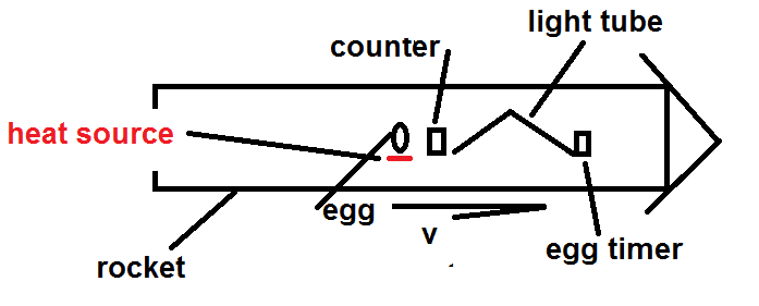

put the pan at the detector end of the tube. An egg timer is placed at the light source. Each time a grain of sand falls thru the egg time a light pulse is triggered. The egg timer has 500 grains of sand. A counter is placed at the pan. when the counter gets to 500 the heat is tuned off. the egg timer is oriented with the direction of movement of the space ship
If the experiment is conducted million of times the counter in the spaceship will turn off consistently quicker than the one external to the space ship

So you turn on the heat when you get the flash corresponding to "first grain falls" and turn it off when you get the flash corresponding to "last grain falls"? This is basically watching a standard egg-timer through a telescope. The egg-timer is the only clock in this setup.
the counter located in the spaceship turns off/on the heat. As the timer in the spaceship turns off the heat early the egg in the spaceship is not fully cooked , where as the egg external to the spaceship is

the set up external to the spaceship is identical to the setup internal to the spaceship
I think you need to explain clearly where you have egg timers and where you have pans, and which ones are moving with the rocket and which ones are moving with the stick man.
see pic

the setup next to the stick man is identical, minus the rocket of course
According to your illustration you have an egg timer, which sends light pulses down a tube to a cooker which remains on as long as pulses continue to arrive.
There is no clock here except for the egg timer.
Ditto the setup outside. Both eggs will cook; both observers will claim the other one cooked slower.
I invite you to do the full Lorentz transforms if you think otherwise.
the egg timer send pulses, the pulses are counted, the cooker starts at the first pulse and turns off at the 500th pulse on the counter. So the cooker in the spaceship starts before the cooker stationary wrt to the stick man. And, the cooker in the spaceship turns off before the cooker stationary wrt to the stick man.

Are you seriously suggesting that this experiment isn't consistent with special relativity? If so, please read the rules on personal theories. If not, you don't seem to be following my verbal explanations of where you are going wrong, so the only thing I can do is suggest that you do the maths. Happy to help if you are having problems with it.

Actually, you don't need the full Lorentz transforms. You simply observe that, in the rocket frame, the timer starts at t'=0 and finishes at t'=500, so the egg starts cooking at t'=T and finishes at t'=500+T, where ##T=2\sqrt{L^2/4+H^2}/c## in terms of the sizes given in #1. It's immediately obvious that if the normal time dilation formula applies to the timer's duration, the same scale factor applies to the cooking. You could, after all, add another egg timer beside the pan and start it when the cooker turns on. It'll run out just as the cooker turns off.
So either the standard time dilation formula does not work for any clock or it shows that the egg cooks exactly as I have been saying - both see the other's egg cooking slower.
