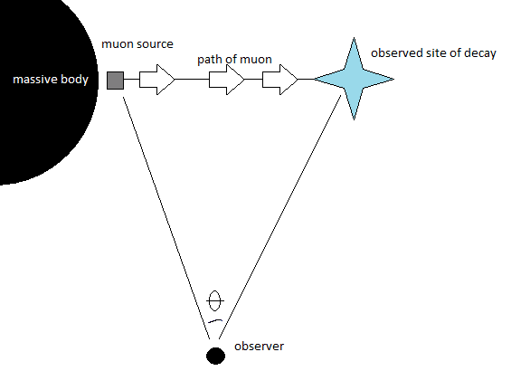

Time dilation and length contraction both occur at relativistic speeds. Because time dilation occurs near massive bodies, does length contraction do too?
For instance, if a stream of muons were released from a box near a massive object and traveled on a straight path slowly (at a non-relativistic velocity) away from that object, a faraway observer would notice that the particles would take longer to decay than a muon typically would in empty space. This is because the presence of the massive object causes time dilation, which in turn, allows the muons to travel a farther distance before decaying, as seen from the observer's perspective. From the muons' perspective though, time is proceeding as usual, and they decay within the normal amount of time. But this causes a paradox. From the muons' perspective, there is no way to reach as far as the final position noted by the observer. In order for an agreement to exist between the observer and the muons as to how far away the particles make it before decaying, their path of travel away from the massive object must be contracted right?
So, taking this question a step further, if an individual were about to fall into an event horizon of a non-rotating black hole with their back turned to the singularity, would they observe a flattening of all objects in the universe onto the skin of the event horizon with them? As they approached the Schwarzschild radius, would the thickness of the universe from their perspective approach zero?

Does the presence of the massive body change theta at all?
In principle, yes, but not because of any "length contraction" or "time dilation". The massive body changes the muons' trajectories--they decelerate as they move upward. So they won't get as far before they decay as they would in free space with no massive body nearby.

Second, the path of light will be affected by gravity, hence you may not be able to interpret your angle ##\theta## the way you want.
Third, any measure of distance in this frame of reference from a point near the body to a point far from the body is not dependent on the muons. If you have such a measurement, then what length contraction are we talking about?
This is a valid point in principle, but in practice there will be a wide range of scenarios where the deceleration of the muons under gravity will be observable while the bending of light won't (it will be too small to matter). I think it's a good idea to get clear about the simpler scenario in which light bending is negligible first.

I'm not sure how you'd calculate the perceived angle ##\theta## here. But, in any case, its independent of any muon motion. It's just what a metre stick looks like in whatever spacetime we have here.
Finally, if the observer uses the local metre stick and his/her own clocks the he/she just gets a meaningless coordinate speed for the muon.
All we are left with here is what a metre stick looks like from a large distance and that isn't what length contraction is about.
I'm not sure what you mean by "independent". It's certainly not independent of whether or not a massive body is present and affects the muon motion by gravitational deceleration. See above.
We may be talking at cross purposes here.
1) there is no experiment under discussion here which does not involve the massive body. The massive body is always present.
2) the muon will live locally for a time (##\tau##) and travel a locally measured distance ##d##. I wanted to assume these were ##1s## and ##1m## respectively.
3) Assume the length ##d## equates to the length of some fixed object, positioned locally.
4) the length of that fixed object is independent of any muons.
5) if there is length contraction between the local frame and a distant frame, then the length of that fixed object must be less than ##d## when measured remotely.
6) the OP, or you, needs to specify a measurement process that would produce this contracted length.
7) it's an interesting question what a metre stick near a massive body would look like " from the side". although what it looks like wouldn't normally be considered length contraction.
PS As the muon is traveling at non relativistic speed I'm taking the local frame and the muon frame to be effectively the same.
PPS that's why I said that any length contraction between the two frames is independent of the muons. Either there is length contraction or there is not and firing a few low speed muons about isn't going to affect that.
