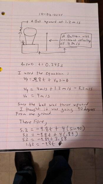

I have a problem that I am working on from my Engineering Dynamics Book and I want to see if I am on the right path. A person in a balloon rising with a constant velocity of 4 m/s propels a ball upward with velocity of 1.2 m/s relative to the balloon. After what time interval will the ball return to the balloon? Answer: t = 0.245 seconds.
I used the equation vy = -9.8*t + v0*sin0(sin of theta).
This is my solution below.

Do I really see a ##\sin(90)=0.89## in your picture?
(you should typeset the math in your post using ##\LaTeX ##!)
Then: The balloon goes up with 4 m/s, and the ball is thrown up with 1.2 m/s relative to the balloon.
So how can you write ##v_0=4## m/s ?
What equation are you solving (or rather: not solving, since you get a negative t) ?

##\sin (90 \text { radians}) = 0.894## approx. You have forgotten to switch your calculator to degrees mode, so it is treating '90' as 90 radians. But in any case, you need to know that ##\sin (90^0) = 1## without using a calculator!
I can’t follow the logic of your working. In addition you have not made clear what your symbols mean, for example:
Is ##v_0##:
- the initial velocity of the ball relative to the balloon?
- the initial velocity of the ball relative to the ground?
- the velocity of the balloon?
- something else?
Is ##v_y##:
- the velocity of the ball relative to the balloon after some time, ##t##?
- the velocity of the ball relative to the ground after some time, ##t##?
- the initial velocity of the balloon relative to the ground?
- something else?
If you deliberately change the meaning of a symbol mid-working (you shouldn't!) you need to state this.
Rethink and try again. Here's a big hint:
You are in an elevator rising at a constant velocity. You throw a ball up at a speed of 1.2m/s relative to you and measure the time it takes to come back to you. Can you find the elevator's velocity from your result?
