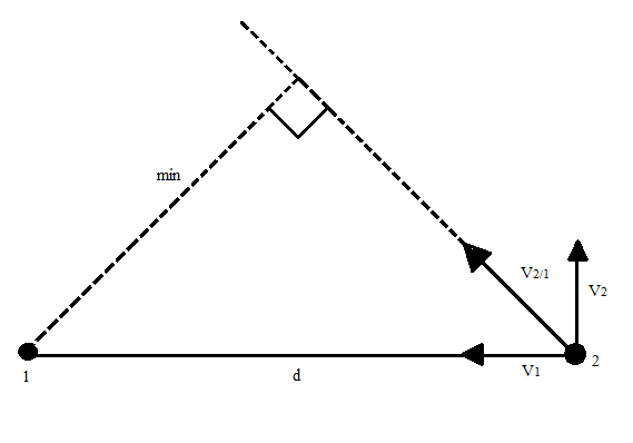

I tried solving this using Galilean transformation. So I set the coordinate system on de first object, like this.
cURo0FY
Then. I ended up with something like this.
OldnRnv
After that, I calculated ##\sin \theta = \frac{min}{d}## thus ##min=d* \frac{v_2}{\sqrt{v_1^{2}+v_2^{2}}}##. Am I right?

I am not able to figure out what your second diagram represents or how you arrive at it.
What is d? Only the given variables should appear in the answer, and it should be symmetric between the subscripts 1 and 2.

Then it points in the wrong direction. It looks more like their sum.

Yes, I know. In class we did something similar. We set the coordinate system on the first particle, so its velocity would be applied on the other particle, but with oposite direction.

No matter, it can be fixed by making the v2 vector point down instead. But I still do not understand the diagram. Please reply to post #4.
Instead of a diagram using relative velocities, you could simply write down the equation for the vector of their relative positions and minimise its magnitude, but I guess you are trying to use a method you have been taught.

@Davidllerenav , In your diagram in post #1 you have the direction of V1 parallel to the initial separation d. I don't think that would generally be a valid assumption.

Yes, I think that was why I could not interpret it. There is a confusion between representations of displacements and representations of velocities.

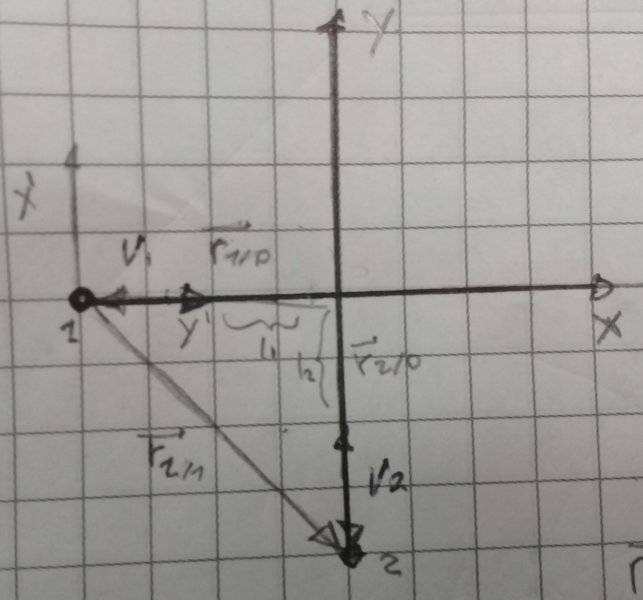

I tried doing it like this. I don't know if I'm right. In case I'm wrong, could you please show how to do it correctly?

Here it is.

Better :smile:
but mysterious to me.
The arrows are all over the place
What's 1 and 2 if ##l_1## and ##l_2## are at the curly brackets ?
and where are the angles @haruspex mentions ?

1 and 2 are the object 1 and object 2.. ##l_1## and ##l_2## are the distances that the particles are at time ##t=0##. I don't know which are the angles. How would the correct diagram be?

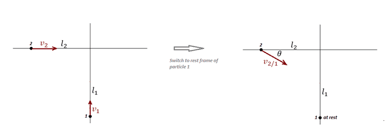

Your idea of switching to the rest frame of one of the particles is a nice approach.
I have particle 1 as moving up the y-axis, instead of particle 2. But, you can make the necessary adjustments. You should be able to get the distance of closest approach by simple geometric constructions and some trig. Note that the angle θ and the magnitude of v2/1 are determined by v1 and v2.

Giving it away, eh :wink: ? But: beautiful graphics :cool: !

I agree. @Davidllerenav, can you now see what previous posts from helpers were aiming at ?
And, probably more important to you: has the penny dropped ?

YYou should be able to get the distance of closest approach by simple geometric constructions and some trig. Note that the angle θ and the magnitude of v2/1 are determined by v1 and v2.
Ok, so the distance between the two objects would be the magnitude of the vector from 1 to 2, right?
At t=0, yes. What about later times ?
And I find the magnitude like this: ##|\vec r| = \sqrt{(\vec r_1)^2 +(\vec r_2)^2}##, and each vector would be equal to: ##\vec r_1 = (-l_1 + v_1*t)\vec j## and ##\vec r_2 = (-l_2 + v_2*t)\vec i##, right?

Yes. But you are only looking for the minimum distance between them. In the figure on the right in post #23, can you draw the line of motion of 2 in this frame of reference? Can you identify the point on the line of motion that corresponds to the minimum distance between them?
  • #31
It would be a line that goes throught the velocity vector. I think that the point that would corresponds to the minimum distance would be when the point 1 and the line of motion of 2 make a prepedicular line, right?
