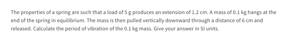

Calculate the time period of mass spring system
See below
I have attempted to draw a sketch of this but can't see how the data they gave me help to find time period
This is what value I have ended up getting but I believe is wrong
Much appreciated for any help!
The period looks OK to me.
Thanks but what threw me off here was the extra info that was provided in the question such as the mass pulling down the spring by a distance of 6cm. I thought I had to use this 6cm somewhere in my calculation?
This is a feature of the simple harmonic motion (which is the one that spring has) that is that the period (time between oscillations) is independent on the amplitude (how big the oscillations are) this feature is not true in general, for example, is not true for a pendulum (although is a good approximation for small-angle oscillations)
Maybe there is more to the problem like writing down the equation of motion. Are you sure this is all there is?
What's a "small angle oscillation" for a spring-mass system moving vertically up and down?
