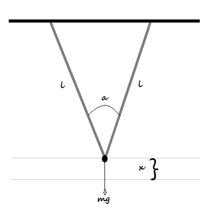

[/B]A heavy mass ##m## is suspended from two identical steel wires of length ##l##, radius ##r## and Young's modulus ##Y##, as shown in the figure above. When the mass is pulled down by a distance ##x## ##(x<<l)## and released, it undergoes elastic oscillations in the vertical direction.
What is the time period?

The vertical components of tension cancel out, while the horizontal components add.
At equilibrium
$$k \cdot l \cdot cos {\frac a 2} = mg$$
With the given small displacement ##x<<l##
$$F=k[l \cdot cos {\frac a 2} + x] -mg$$
$$\Rightarrow m \frac {d^2 x} {dt^2} = -kx$$
$$\Rightarrow \frac {d^2 x} {dt^2} = -\omega^2 x$$
Where ##\omega = \frac k m = \frac {mg} {m \cdot l \cdot cos {\frac a 2}} =\sqrt {\frac {g} {l \cdot cos {\frac a 2}}}##
So time period
$$T = \frac {2\pi} {\sqrt {\frac {g} {l \cdot cos {\frac a 2}}}} = 2\pi \sqrt {\frac {l \cdot cos {\frac a 2}} {g}}$$
But, I cannot use the expression for the Young's modulus. What am I missing?

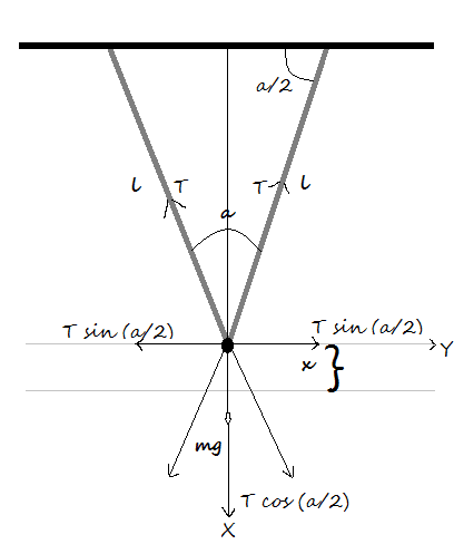

So, if the tension on the wires is ##T## (assuming both of them to be equal, and of course ##T\neq0##, as you pointed out), the first equation modifies to $$k \cdot l \cdot cos {\frac a 2}=mg + 2\cdot T \cdot cos {\frac a 2}$$
right?
Then how will I get the equation of motion?
You have to find the restoring force for a given displacement and use Newton’s second law.

I'm not sure how to obtain the expression for tension ##T##!
Is it, $$T\cdot cos {\frac a 2}=mgx$$?
But it seems that the ##cosine## component of ##T## gets added downward.
Then how will I obtain ##k##?

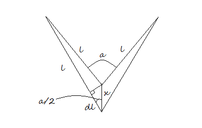

When system displaced by x then what is elongation in steel rod?
Since the displacement is very small ##x<<l##,
$$\frac {x} {\Delta l} \cong cos {\frac a 2}$$
So, $$\Delta l = x\cdot sec {\frac a 2}$$
Is it?

haruspex said:
ΔL cannot be more than x. Try again.
Oh!
$$\frac {\Delta l} {x}= cos \frac a 2$$
$$\Rightarrow \Delta l = x \cdot cos \frac a 2$$
Is it okey @haruspex ?
Now using this ##\Delta l## in the expression for Young's modulus, I obtain
$$Y= \frac {Tl} {A \Delta l}$$
$$\Rightarrow T= \frac {Y \pi r^2 x cos \frac a 2} {l}$$
Then I need to equate ##T## to ##m\vec a##?

VSayantan said:
Oh!
Yes this is right
Note that what you have computed is the difference in tension between the equilibrium point and the position ##x##, not the actual tension. The tension at the equilibrium point is just enough to cancel the gravitational force and need not be computed. It would be given directly by the geometry of the problem and the weight of the object.
