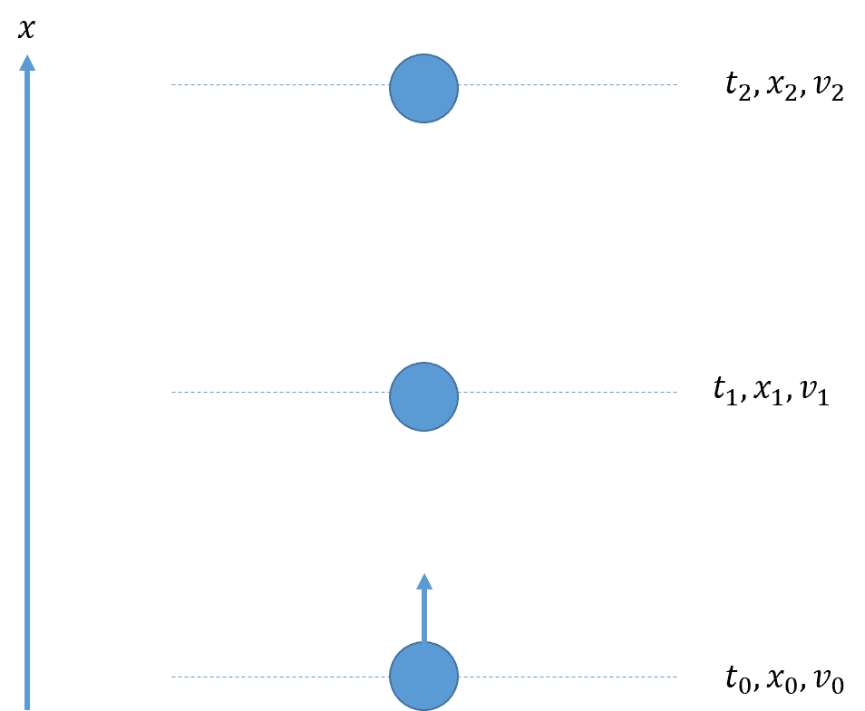

I don't understand how does time-reversal applies to the free-fall problem.
I try to justify time-reversal symmetry in a very simple classical problem; Free Fall. The position, ##x##, and the velocity, ##v## are obtained versus time from the equation ##-g=\ddot x##. So, if we consider the primary conditions as ##t_0,x_0,v_0## it is clear that, ##x(t)=\frac{1}{2}(-g)(t-t_0)^2+v_0(t-t_0)+x_0## and ##v(t)=-g(t-t_0)+v_0## give teh position and velocity at any time. Plesase see the attached figure. AT the point (1) we have$$x(t_1)=x_1=\frac{1}{2}(-g)(t_1-t_0)^2+v_0(t_1-t_0)+x_0$$ and $$v(t_1)=v_1=-g(t_1-t_0)+v_0.$$ We expect by applying time reversal to obtain ##x(-t_1)=x(t_1)## and ##v(-t_1)=-v(t_1)##. However, inserting ##-t_1## instead of ##t_1## doesn't neccesarily fulfill this requirement:
$$x(-t_1)=\frac{1}{2}(-g)(-t_1-t_0)^2+v_0(-t_1-t_0)+x_0$$ and $$v(-t_1)=-g(-t_1-t_0)+v_0.$$ I would like to know what is my mistake? FFP.png
It's a bit a subtle point you stumbled on. Time reversal doesn't simply mean that you make ##t \rightarrow t'=-t##, but you also have to start with the time-reversed initial condition, i.e., ##x_0'=x_0## and ##v_0'=-v_0##. Also accelerations don't change under time-reversal, i.e., ##g'=g##. Now take your solutions (for convenience I set ##t_0=0##)
$$x(t)=-\frac{g}{2} t^2 + v_0 t +x_0.$$
Now let's look at the time-reversed process. Just make the above transformations of both the time variable and the initial conditions. Then you get
$$x'(t')=x(t)=x(-t')=-\frac{g'}{2} t^{\prime 2} -v_0 t' + x_0'=-\frac{g}{2} t^{\prime 2} + v_0' t' + x_0',$$
which is the same as the original solution. This reflects time-reversal invariance of your mechanical system.

Many thanks for your reply.
However, I still don't know the time evolution of the system in the time-reversal state. Better to say, consider the following figure. The left panel shows the motion in the direct time and the right panel, in the time-reversal states. What is the time evolution of the system in the right panel? The particle must fall from the point with ##-t## to the point ##-t_0## or vice versa?
In other words, as shown in the schematic clock at the rightmost figure, which direction is the time evolution in the time-reversal state (between the two times ##-t## and ##-t_0##) ?
Time evolution is always forward i.e. from smaller to larger values of ##t##, i.e., your time-reversed situation describes free fall of a particle starting at time ##t##.
So, it seems that time-reversal doesn't give a new solution to equation ##x\ddot =-g ##, and only changes the initial conditions. We could set the initial conditions at the top with a downward velocity, and then exactly the same motion would occur. In other words, Time reversal doesn't present a new motion!
Likes vanhees71
That's the point! It leads again to a solution of the equations of motion, which means that Newton's law for the given force law is invariant under time reversal.
Likes PeroK and hokhani
