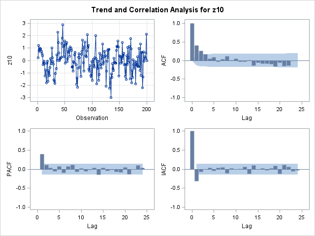

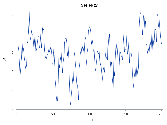

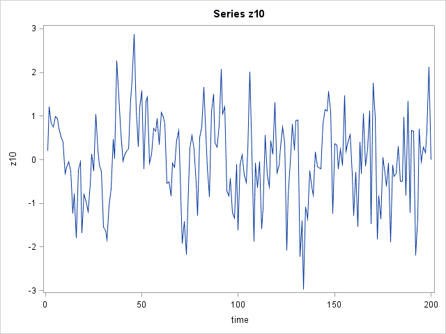

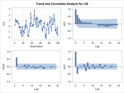

I am taking an introductory course in Time Series and our initial study of ARMA processes has proven to be challenging for me. The math we are asked to do is quite simple but recognizing various attributes is tricky.
We are given 5 time series and are asked to label them from a given list of various types. I've correctly identified all but 2. The two left to use are:
1) Weakly stationary
2) Non-constant auto correlation function
I've looked up the definition for weakly stationary and it's far beyond what we have been given to use in lectures, so I imagine there is something simple I should notice about them versus strictly stationary. I still can't find any information on a non-constant ACF and would greatly appreciate any links to materials.
Here are the two series in question:
z7:
z10:
And here are some other useful time series analysis results to possibly use:

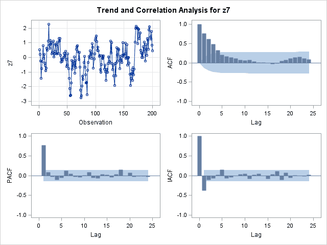

z7: View attachment 1954
z:10View attachment 1955
Sorry for all the graphs but this is a portion of the output I've produced. I'm coding all of this in SAS, which is a language I'm pretty comfortable in so can adjust the above in various ways if necessary.
Any comments on the nature of weak-stationary and/or non-constant ACF series? Any comments on the attached images?
Thank you!
Jameson

The noise (or residual) series for an ARMA model must be stationary, which means that both the expected values of the series and its autocovariance function are independent of time.
The standard way to check for nonstationarity is to plot the series and its autocorrelation function. You can visually examine a graph of the series over time to see if it has a visible trend or if its variability changes noticeably over time. If the series is nonstationary, its autocorrelation function will usually decay slowly.
If I look at the ACF graphs, I can see that the z10 series decreases fairly quick and would therefore be weak-stationary.
The ACF of the z7 series decreases slowly and would therefore be non-constant.
Hmm, I'm not sure I understand this. I agree that the ACF of z7 takes longer to move within the error bands than z10 but how does this relate to the average? Unfortunately our professor never really defined "non-constant ACF". You're saying that "non-constant" and "non-stationary" are essentially the same, correct? That sounds reasonable.
With an AR(1) process, the ACF will decrease exponentially in a similar way to z7 so I don't see how this alone shows us that it's a non-stationary process. If unprompted I could even see an argument that z7 is a AR(1) process since the ACF decreases exponentially and the PACF has a sharp cut off after lag 1. I know that this isn't supposed to be the answer though so how can I distinguish it from an AR(1)?
Ultimately it is not about the ACF - it is about the time series, whether it contains global trend or not.
Perhaps you can make moving average graphs of, say, around 20 time units?
Those should show global trends.

My professor suggested chunking of the series into smaller bits. Is this what you mean? There are 200 observations so I could split that into 4 regions: 1 to 50, 51 to 100, 101 to 150 and 151 to 200.

While I'm doing that I have an observation about the two graphs in the OP. The mean for z10 seems much more concrete than the one for z7. In fact, z10 could almost be a stationary process so it makes sense to call it the weak stationary one. I am trying to imagine an ACF graph that is non-stationary and have no idea what that would look like. Maybe it would decrease to 0 and then go back up again? :confused:

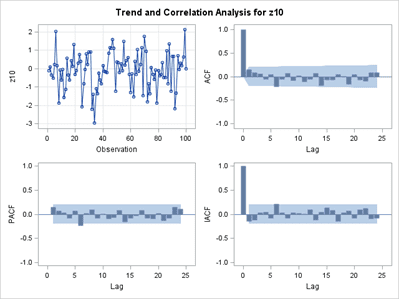

So I met with my professor and found that z8 is weakly stationary, but I didn't show that to you guys so my apologies. :o
z10 is a non-constant ACF series by the following graphs. The first image represents the first 100 observations and the second one, the second 100 observations.
There are big differences in both the ACF graphs and PACF graphs here, which is clear now. Before I really didn't know what I was looking for, thus was asking for help with incomplete information.
Thank you for your comments ILS!
