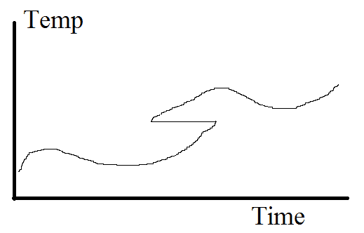

Reminds me of a "Temperature vs Time" graph from a weather monitoring station.
I was puzzled in the morning to see the previous night graph, which somewhat looked like the image attached.
Because of a November "daily saving time" change, time went back one hour.
This complicates data analysis, since the same clock time can now have 2 different temperature associated with it.

That is why you should time stamp data using UTC.

True but it is not always so easy. Many activities depend on human behavior, not physics. Things like rush hour traffic patterns, or peaks and valleys of electric power usage. Imagine the chaos if your doctors office made future appointments on UTC.
In my business, we sold things and kept records by the hour and day. Because of daylight savings time, we had to make the software work with 23, 24, and 25 hour days. It gets harder if your business span time-zone and daylight savings borders, it can become challenging. Many times I wished that time keeping was as simple as UTC.
Save it in UTC and (if necessary) in local time?
I think most databases do that. Certainly nearly all web pages.
You'll get weird patterns for two nights (no entries in 1 hour, twice the normal entries in the same hour on a different day), but apart from that everything works nicely.
@anorlunda - part of locale settings, available for almost any extant computer, is the timezone setting. This takes handles UTC -> (local time & date) and also the other way: (local time & date) -> UTC. There is also timezone database (was Olson now housed at IANA). It handles all of the politics involved in daylight time transitions and when and if the time changes. Example - The Knesset (Isreali parliament) determines each year when daylight time starts. Th IANA database keeps track of this kind of thing on an ongoing basis.
