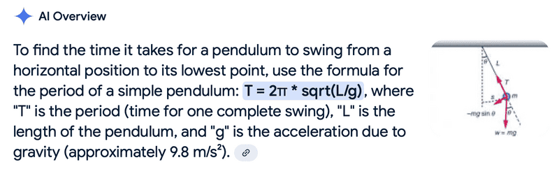

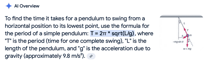

I thought I might gain some insight on how this has already been approached and searched for the swing time of a pendulum starting from the horizontal which is this problem in the no-friction limit. The first thing that popped up was, as is usually the case with searches nowadays, the AI Overview which I show below.
Clearly, here "AI" stands for Artificial Ignorance since an amplitude of 90° is outside the realm of the "small angle" approximation in which T = 2π * sqrt(L/g) can be used.
