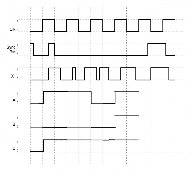

Complete the timing diagram for the following circuit:
So I was doing some pre-midterm studying, and I was slightly confused with the operation of this circuit.
I think part of the solution provided is incorrect, but I'm not positive so I thought I would ask. Here is my attempt so far at filling in the waveforms:
I believe the value of ##B## provided at that clock edge is incorrect (the place where I have not connected the lines).
At that rising clock edge, the rising edge triggered D flip-flops will start by copying the value of ##\bar x## into ##A##. Hence why ##A = 1## at that clock edge.
Then looking at the NOR gate before the second D flip-flop, the inputs should be ##A = 1## and ##x = 0##. This results in ##0##. Should this not imply that ##B = 0## and not ##B = 1## as they have provided?
EDIT: I also forgot to ask, does synchronous reset have any impact on a rising edge triggered D flip-flop for a falling clock edge? I have ignored the reset in the early portions of the waveform because it was a falling clock edge.
Wait wait, I think I see how I was reading the diagram incorrectly before. Would this be the answer:
These are positive edge-triggered?
To me it looks like B should be low at all times, since either x or A is high on CLK. C should then be high after first CLK until reset, since x AND B is never true.

Yes, these are rising edge triggered (probably master-slave d-latch) D flip-flops. So when the CLK is high, the master is transparent and the slave is latched.
I also thought ##B## should be low at all times at first, but they provide part of the solution, and ##B## goes high at one point. This changed the way I interpreted the diagram.
If ##B## really does go high at the point they have indicated, then the only way that could happen is if they are sampling the values of the input variables ##x## and ##A## just before the rising clock edge.
So for the point where ##B## goes high in the solution they provided, I read it like so:
##x = 0## before the rising edge.
##A = 0## before the rising edge.
##0## NOR ##0## is ##1##, therefore ##B = 1## just after the rising edge.
I think this is because of the operation of the actual D flip-flop itself. They way it sends the values through just after the clock goes high, but it samples them a very small instant just before the clock goes high.
Therefore, I believe the image in post #2 is correct.
I agree with the wave form for B in post #2.
The data on D is sampled on the rising edge of the clock only. The data must be valid for a short time (Tsetup) before the rising edge and held for a short time after the rising edge (Thold). Apart from that changes to D at any other time do not effect Q.
So looking at the second latch...
Just prior to the first rising edge of clk... X = 0 and A = 0. So the data input to the latch will be 1. That means after the rising edge B = 1.
Just prior to the next rising edge of clk .. X = 0 but A = 1. So the data input to the latch will be 0. That means after the rising edge B = 0.
etc
