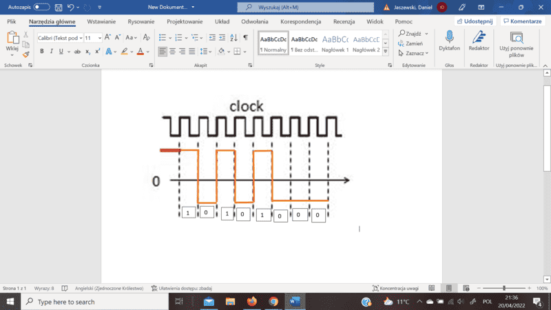

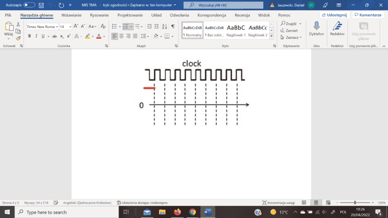

Using the grid below, sketch a waveform to show how the data 10101000 would be transmitted to line using Non-return-to-zero inverted (NRZI) line encoding. Assume the signal level is initially high as shown.

You need to show your attempt at this problem. I thought that I made that clear in my previous PM to you...
Sorry. What i have is this
That looks close, but the "Inverted" part of NRZI means that you should invert that plot, no?

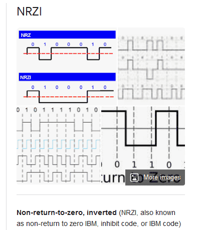

From the Google search preview:

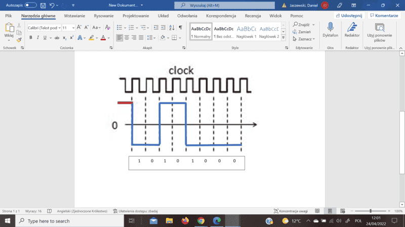

I think the "I" is more complicated than that - it doesn't just invert the levels of NRZ, it is a completely different (and poorly named) edge-based system (an edge of either sign is a 1 and the absence of a signal edge on a clock pulse signifies a 0).
https://en.wikipedia.org/wiki/Non-return-to-zero#Non-return-to-zero_inverted

As I understand it NRZ-I and NRZ(I) are the same thing as NRZI: I have only ever seen it called NRZI (e.g. in the USB 2.0 specification) and importantly the "I" originally stood for IBM and was nothing to do with inversion (see http://ibm-1401.info/223-6988-729-MagTapeCE-InstRef-62-r.pdf).
This is totally different from NRZ, also called "on-off keying" where 1 is normally represented by a high voltage and 0 a low voltage: I am not aware of the opposite convention having a specific name, I suppose you could call it "Inverted NRZ" but that would just add to the confusion!

What about now.
I have a starting point which is higher voltage level and every time when I encounter a 1 i have to change a voltage level. Hope is good now.
Looks good to me.
