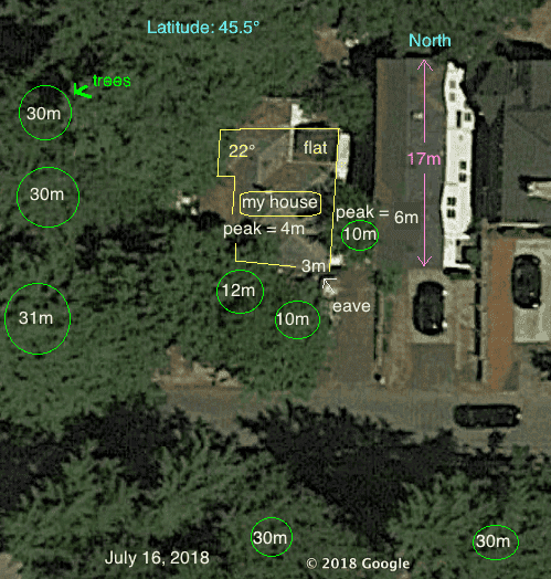

Today it's supposed to be 99°F/37°C, so I may turn on my attic fan. It's a 12 volt experiment left over from last year, and isn't permanently wired.
Currently, it's about 9 am(savings time, so 8 am in real time) in the morning, and the temperature outside is the same as in. About 72°F/22°C.
Attic temperature is 70°F/21°C, so it appears I have a bit of time left.*
Crawl space temperature is a surprising 67°F/20°C. I'd have thought it would be much cooler than that.
*Done!
Well, that was interesting.
The fan made things worse!
I think it's because the exterior surface of the roof's temperature was 68°C/154°F, and that's where half of the intake air was coming from.
The other half of the intake air was ambient exterior temperature: 29°C/85°F
Just guesstimates on the proportions of course. It's much too hot to do anything more than eyeball things in this kind of weather.
Anyways, this is good to know.
Hopefully, we have some more nasty hot weather again tomorrow, so I can continue this experiment.

hmmmm... None of this makes any sense to me. I suspect it's mostly my fault, as I should have repeated that I do have an A/C unit in operation, and the internal temperature should be ignored. Consider it a "baseline".
Interestingly, the outside temperatures were both within 1°C of each other for days 1 and 2.
Also interesting, is that even though the attic exhaust fan was run at opposite times of day, the attic temperatures were also within 1°C of each other.
This indicates that the exhaust fan had near zero effect.
I suspect this is due to the area of the roof/ceiling of ≈84 m2, along with a solar irradiation factor of 1000 watts/m2, yields 84,000 watts.
My guess is that my attic system is currently designed for natural convection, and would require more modification than just a fan to fix this.
New obligatory graph, with less noise, and more information:
There be very tall trees to the south and west of my house.

I have 3 roof-peak vents, and about a dozen soffit vents. If you do install an attic fan, I would recommend not leaving open any spare roof-peak vents, as they kind of negate that type of improvement, IMHO.

jim hardy said:
I ran a garden hose up to the roof and placed three yard sprinklers along the peak.
I've done this before, and I reinstalled it again a couple of hours ago.
Around noon and a a couple times mid to late afternoon i turn them on for five or ten minutes.
I've turned in on for about 3 minutes, at the top of the hour.
As indicated by my earlier graph, I get rooftop sun in the morning, and zero in the afternoon.
Though I plan on maintaining the hourly "watering", to see the effects.
It was supposed to be 100°F/38°C today, but the hazy cloud cover is a bit more than normal, so I don't think we'll hit that today.
I see steam coming from the hot shingles and feel a slight difference in radiant heat inside the house.
Haven't seen any steam yet.
I'm not instrumented so it's un-scientific
I have spare shingles from my DIY roofing project. I've been considering building a mini-me roof in the driveway, with just a single shingle, tar paper, and 1/2 inch[13 mm] pine board, with temperature sensors at each layer, but..., that sounded like a lot of work.
Yesterday, I successfully went the whole day without A/C.
I suspect it may have been because I was measuring temperatures in Celsius, and had not a clue how hot it was. :biggrin:
Doh! Top of the hour. Time for more measurements.
