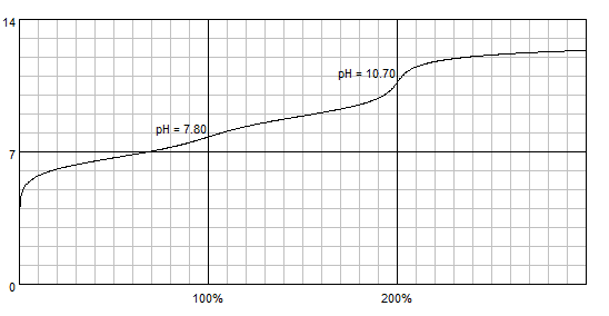

The solution given is definitely wrong. This is how the titration curve for a substance with pKa1 = 6.7 and pKa2 = 8.9 looks like:
(calculated with BATE). End point is 10.7, not 7.8.
Solution - as given - doesn't make much sense. You are right about the 15/30 part - it is simply wrong. Then, isoelectric point is not the endpoint, so the equation for isoelectric point doesn't apply.
