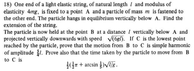

Could I please ask for help with the following:
It's the final part I am having problems with.
So at this point we know we have SHM of amplitude (5/4)L
Now, using x = a cos(nt) ----- where we now know that n = sqrt(4g/L)
we can find the time at which x has any value.
So for exmaple, when x first equals (5/4)L we have:
(5/4)L = (5/4)L * cos( sqrt(4g/L) t ) which leads to t = 0, as expected.
Now, to find when x first arrives at C is to find when x first has a value of -(5/4)L giving:
-(5/4)L = (5/4)L * cos( sqrt(4g/L) * t1 ) which leads to:
t1 = (PI/4)*sqrt(L/g)
Similarly, to find when x first equals L/4 (i.e. when the mass is first at B) we can use:
L/4 = (5/4)L * cos( sqrt(4g/L) * t2) which leads to:
t2 = sqrt(L/g) * arccos(1/5)
and so time taken to move from B to C is:
t1 - t2 = (1/2) * ((PI/2) - arccos(1/5)) * sqrt(L/g)
which is not quite the desired answer.
Thanks for any help,
Mitch.
At ##t =0## the mass is at ##B##, which is not at an amplitude of ##5l/4##. I think you have to calculate where in the SHM cycle the motion starts.
Hint: you should be looking at motion of the form ##A\sin(\omega t + \phi)##.
PS I just checked through this and get the book answer.
Thanks for your suggestion, that really helped. So I've almost get there but I have sign out, can you spot my error?
So I use ##x=A\sin(\omega t + \phi)##
And we have that ##A=\frac{5l}{4}## and ##\omega=\sqrt{\frac{4g}{l}}##
In order to have ##x=\frac{l}{4}## when t = 0 we need to have ##\phi=arcsin(\frac{1}{5})##
So to find time to C we need to solve:
##sin(\sqrt{\frac{4g}{l}}t+arcsin(\frac{1}{5}))=1##
which leads to:
##t=\frac{1}{2}(\frac{\pi}{2}-arcsin(\frac{1}{5}))*\sqrt{\frac{l}{g}}##
and I have a minus instead of a plus. Thanks for any help.
If ##x(0) = \frac l 4##, then what is ##x## when the mass is at ##C##?
In fact, perhaps think more carefully about taking ##x(0) = \frac l 4## in the first place!
I see, at C, ##x=-\frac{5l}{4}## (I had not used the negative)
This would lead to:
##sin(\sqrt{\frac{4g}{l}}t+arcsin(\frac{1}{5}))=-1##
and so
##\sqrt{\frac{4g}{l}}t+arcsin(\frac{1}{5})=-\frac{\pi}{2}##
and so:
##t=\frac{1}{2}(-\frac{\pi}{2}-arcsin(\frac{1}{5}))*\sqrt{\frac{l}{g}}##
Sorry if I'm missing something obvious, but I'm still off.
This would lead to:
and so
and so:
##x(0) = \frac l 4## doesn't fit with taking the ##\phi## you got. If you differentiate your equation you find that the mass is moving away from equilibrium at ##t =0##.
You could fix this by taking a different ##\phi## - note that more than one ##\phi## gives the same value of the trig functions. In any case, you need a different ##\phi## to get the correct position and velocity for the motion at ##t = 0##.
Taking ##x(0) = -\frac l 4## and ##C## as ##+\frac{5l}{4}## is perhaps the simplest approach.
OK, that's very helpful indeed. I had not been looking at the direction of the velocity. Thanks very much for all your help. I'll work through it all agian to be sure to understand it fully.
