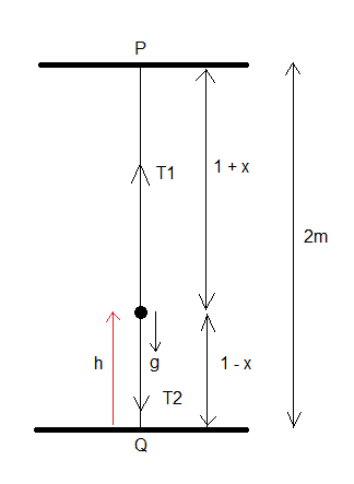

Hi, can anyone see if I have made an error in answering this simple question, my answer is not the one given in the textbook.
Here's my diagram of the system in equilibrium. So the mass has dropped a distance x below the midpoint of PQ:
So the forces balance as:
T1 = g + T2
So, using Hooke's law T = Yx/a (where 'Y' is the modulus of elasticity of the string and 'a' the natural length of the string) we have:
( 4g( (1/2) + x) ) / (1/2) = g + ( 4g( (1/2) - x) ) / (1/2)
Because both parts of the string above and below the mass have a natural length of 1/2 and the part above is of length 1 + x and so has an extention of (1/2) + x and that below the mass is of length 1 - x and so has anextention of (1/2) - x
This solves to give x = 1/16 and so the height above Q would be 15/16.
The book answer if 3/4 = 12 / 16.
Thanks for any help,
Mitch.

Why not try again using ##h##?
I'm really confused by your equations involving ##x##.
Okay. I see what you are doing with ##x##. It looks correct from what I can see.
Why introduce ##x##, when it's ##h## you want?

I can repeat with equations in terms of h. This gives:
4g*(2-(1/2)-h)/(1/2) = g + 4g(h-(1/2)/(1/2)
This leads directly to the same answer of h = 15/16
But thanks for saying that you believe I am correct. The book I am using is rarely wrong. Having other people tell me that they agree with me gives confidence that the book may indeed be wrong in this case.
If I understand what you are doing this solves to x=1/4 and the book is correct. ( your answer is fine but your arithmetic is even worse than mine! )

No, I think you lose the arithmetic contest, on consensus at least. I also get 1-x=15/16.
Another flaw in the question is stating the elasticity as "4gN". g has dimension; the "N" is superfluous.
If I start with this (from #1)
( 4g( (1/2) + x) ) / (1/2) = g + ( 4g( (1/2) - x) ) / (1/2)​
Then
8gx=2g
x=1/4​
2( 4g( (1/2) + x) ) = g + 2( 4g( (1/2) - x) )
( 4g( 1 + 2x) ) = g + ( 4g( 1 - 2x) )
4 ( 1 + 2x) = 1 + 4( 1 - 2x)
4 (1+2x-1+2x) = 1
16x=1
Start with T = Y*(Δl ± x)/L where Δl = 1 , L=2
Then 4g(1+x)/2 = g +4g(1-x)/2
x= 1/4

You know I should never do arithmetic (or anything for that matter at my age) after 10pm. I worked the problem through today and concur with majority. Apologies.
