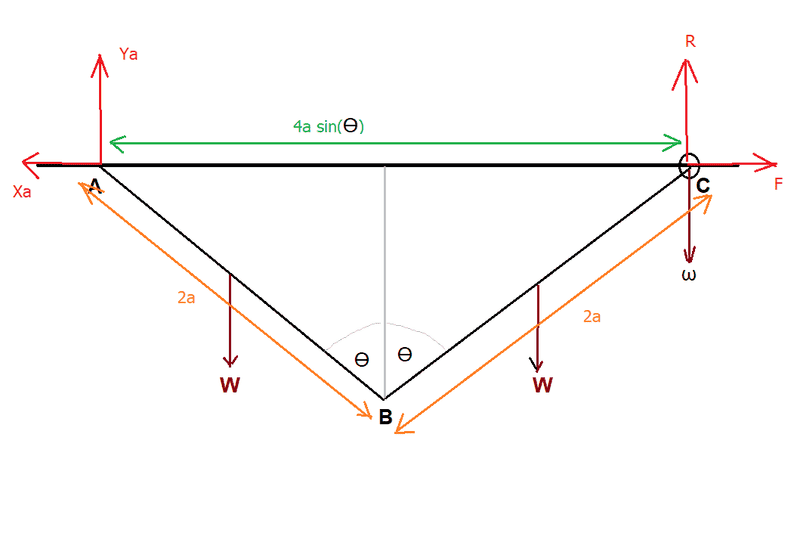

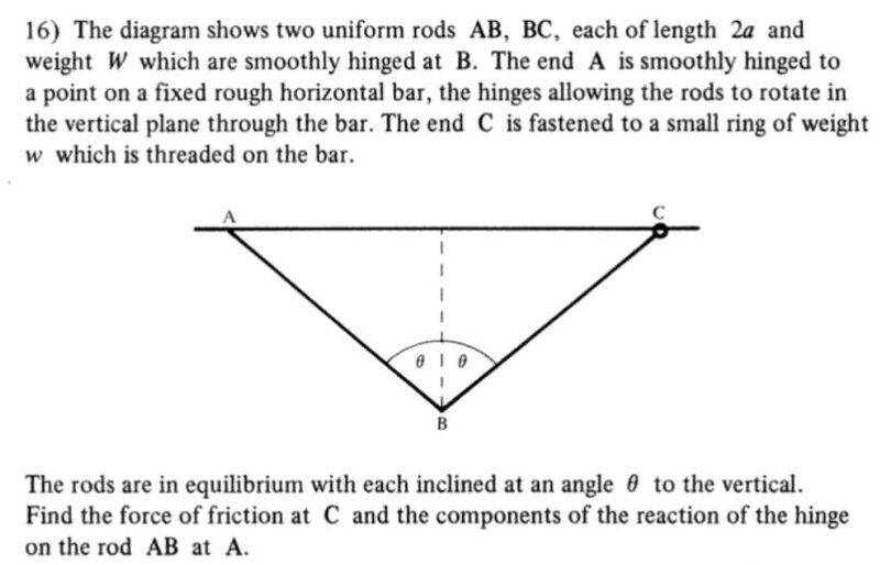

Could I please ask where I have gone wrong with my reasoning in the following question:
The answers in given in the book are:
(1/2)W tan(Ө)
W
vertically
(1/2)W tan(Ө) horizontally
Here is my diagram:
Considering the system as a whole:
(In the text below "Ya" and "Xa" are the forces at the hinge at A)
Resolving vertically gives:
Ya + R = 2W + ω (call this "equation 1")
Resolving horizontally gives:
F = Xa (this agrees with the book answer)
Taking moments about C gives:
W * a sin(Ө) + W * 3a * sin(Ө) = Ya * 4a * sin(Ө)
which gives:
Ya = W (this agrees with the book answer)
And so from "equation 1" we have that R = W + ω (call this "equation 2")
Now, considering the ring alone and taking moments about B gives:
R * 2a * sin(Ө) = ω * 2a * sin(Ө) + F * 2a * cos(Ө)
which gives:
R * tan(Ө) = ω * tan(Ө) + F
So using "equation 2" gives:
F = W * tan(Ө)
But book answer is F = (1/2) * W * tan(Ө)
Where have I reasoned wrongly?
Thanks for any help.
You have forgotten the moment (torque) produced by BC's weight.
Thanks very much for that. Indeed, if I include the torque produced by BC's weight everything works out.
This torque is given by W * a sin(Ө)I guess I am having trouble justifying to myself, why, when I am considering forces on the ring only, I need to include W due to the weight of BC in this way. If I imagine a diagram with the ring only then, if anything, I would label the force on the ring due to BC as being an arrow pointing vertically downwards from the ring of magnitude W. But then it's moment about B would be be
W * 2a * sin(Ө)
not W * a * sin(Ө) as I use above to get the right answer?
How am I thinking of this wrongly?
*EDIT* I think that my confusion is one of visualization. I think that, "mentally", I should be thinking in terms of considering "the rod BC and the ring" as the entity which I am considering in isolation, rather than just "the ring", then indeed I would use W * a sin(Ө)
