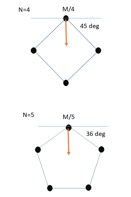

@Kaushik, you are correct that the centripetal force on differential element of mass, [itex] dm [/itex] is
[itex] dF = (dm) \omega^2 r [/itex]
(Same thing as [itex] dF = dm \frac{v^2}{r} [/itex])
But the thousand dollar question is, "Is that the same as the tension?"
And the answer is "no," at least not according to my calculations. But fortunately, they are related.
While I won't tell you what that tention is, I'll explain how I found a formula for the tension.
Instead of the ring being a continuous band, model it as 4 pieces of mass, each with mass [itex] M/4 [/itex], held together by massless strings. The four masses are rotating around their center with angular velocity [itex] \omega [/itex].
Calculate the centripital force on one of the masses. You know that that force must come from the the two strings (one on either side): Specifically, the component of the tensions that are directed toward the center. You can then use algebra to solve for the tension, [itex] T [/itex].
Now move on to more masses. For example, 5 masses. Do the same thing. The two things that change is the individual mass is now smaller (M/5 instead of M/4), and the angle becomes smaller too. Look for a pattern here.
Now try to find the formula for the tension [itex] T [/itex] for a system of [itex] n [/itex] masses.
Once you have a formula for the tension with [itex] n [/itex] masses, take the limit as [itex] n \rightarrow \infty [/itex].
The result should be rather pleasing, although not too terribly surprising.
[Edit: Hint: although I used degrees to represent the angles in the above figures, you might find it advantagous to use radians.]

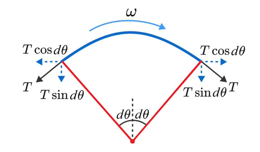

Yes, a FBD is essential to one approach for solving this. Perhaps the below image will help. It shows a small length ##2rd\theta## of the ring. Now equate the tension forces with the centrifugal force, use the small angle approximation for the sin function, and then solve for T. Once you have T you can solve for the change in length by using Hooke's law.

As per the figure provided by @mfig, Tension is tangential to the point where the ##dm## mass is considered. These are the only forces that act on ##dm##. The component of Tension towards the center provides the centripetal acceleration.
Ok, but what is the algebraic expression for that component?
Likes Kaushik
From this figure,
##2T\sin(d\theta) = (dm)\omega^2r##

Kaushik said:
From this figure,
Ok, but how can you simplify ##\sin(d\theta)## and how can you express dm in terms of dθ?
As ##d(\theta)## is infinitesimally small, ##\sin(d\theta) \approx d\theta##
Also, Is ##dm = \frac{Md\theta}{2\pi}##
That's right.
Be careful here. Take a look at @mfig's diagram carefully. What is the total angle that the small section of ring extends?
Likes Kaushik
Oops! I drew a different diagram on my notebook.
According to the figure provided by @mfig, is ##dm = \frac{Md\theta}{\pi}##?
Your problem statement did not mention M anywhere, so why introduce it? I see a density, which I assume is a linear density (kg/m) since we are told the ring is thin. So from the FBD I posted,
##dm = 2 \rho rd\theta##
Now plug this into the expression you got previously (##2Td\theta = r\omega^2dm##) to yield an expression for the tension in terms of your original problem parameters:
##T = \rho r^2\omega^2 ##
Likes Kaushik
