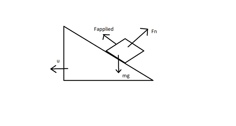

I did. Here it is.
##F_a-mg\sin \theta=ma##
##F_a## as applied force
What is slant distance of the wedge s?
If we know that then
##(F_a-mg\sin \theta)s=\frac12mv^2-\frac12mu^2##
v as final velocity.

Sorry, I hit the 'Post reply' button by accident before I'd finished my reply. So I deleted the post. I'll try again...
You haven't defined your variables. For example you use ‘##F_a##’ in your post but the diagram doesn’t show it. Your diagram shows ‘##F_{applied}##’. Are these meant to be the same? If so, you shouldn’t use different names for the same quantity. It causes confusion.
But, more importantly, I think the question (and therefore your diagram) is wrong. And using ##\eta## creates a readability problem. I’ll use ##\alpha## instead of ##\eta##.
Is the question word-for-word as printed in your book? Or have your reworded it?
I’m guessing the real question is this:
1. A block, mass m, moves at speed u on a horizontal frictionless surface.
2. The block meets the thin end of a stationary frictionless wedge resting on the surface. The wedge’s mass is ##\alpha##m and its height is h.
3. The block slides up the wedge, simultaneously making the wedge move.
4. Find an expression for the minimum value of u for the block to reach the top of the wedge.
Hints (assuming the above is the correct question): Don’t try to solve this using forces. Use conservation of momentum and conservation of energy.

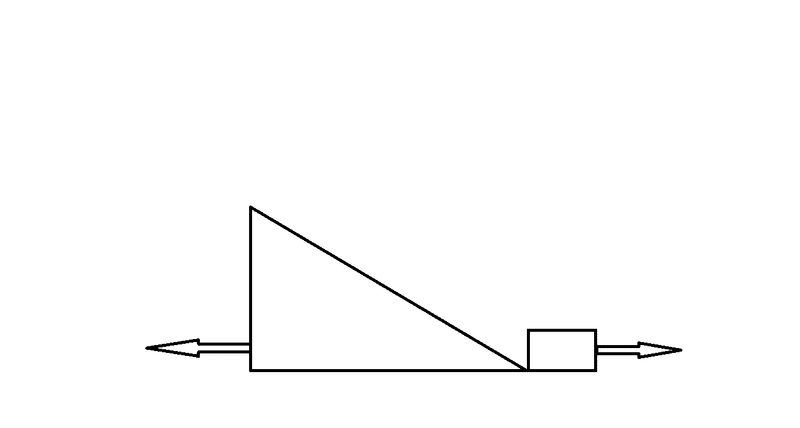

Let’s assume the question is as described in Post #4.
This is what happens:
When the moving block (initial velocity u) and stationary wedge meet, the block will slide up the wedge and also the wedge will accelerate.
For some value of u, the block will just reach the top of the wedge. At this instant, the block and wedge will have the have same velocity, say v.
Here is an outline of what you must do.
Using the conservation of momentum. calculate v in terms of u, m and ##\alpha##.
If you haven’t learned about conservation of momentum for simple ‘collisions’ you need to read-ahead and/or watch a YouTube video or two.
After you have an expression for v, you can use conservation of energy to find u in terms of m, ##\alpha##, h and g.
Post your attempt, showing all your working.

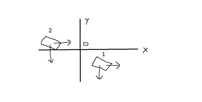

I think it should be the component of weight that will slow down the block. The normal component is not in opposite direction to motion of the block.

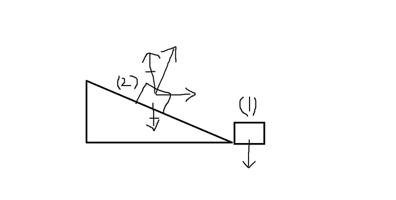

Also is there any action reaction(Newton's third law). I think there is at the instant the block touches the wedge.
For a block (B) sliding up a non-accelerating (e.g. fixed) wedge, that’s a sensible way to think about it.
But here the wedge is accelerating. That complicates the problem.
It is simpler to think about the separate vertical and horizontal components of B’s velocity.
B’s weight (##\vec W_B##) acts vertically downwards so it has zero horizontal component.
Therefore B's horizontal acceleration cannot be produced by a component of ##\vec W_B##.
B's horizontal acceleration is produced by the horizontal component of the wedge's normal reaction on B.
The net vertical force on B is the vector sum of ##\vec W_B## and the vertical component of the normal reaction of the wedge on B. B's vertical acceleration is produced by this net vertical force.
It should be clear that solving this problem using momentum and energy is simpler than using forces. Part of the skill of physics problem-solving is recognising which approach to take.
Yes of course. It is impossible for there not to be. They are:
- the normal reaction of the wedge on B and
- the normal reaction of B on the wedge.

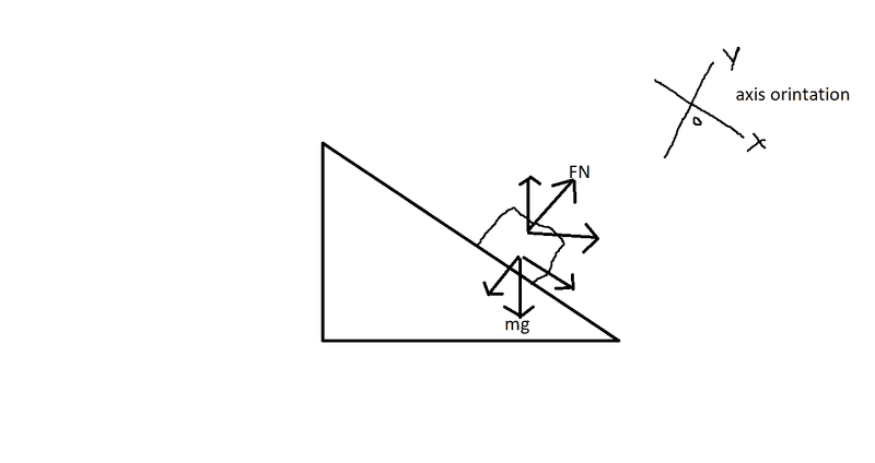

By taking the x and y-axis parallel to the slope and perpendicular to the slope of the wedge, I have drawn the fig. Please see. Clearly its the horizontal component of the weight of the block that is slowing down the block.
The weight acts vertically downwards. Its horizontal component is ##mgcos(90º) = 0##! [typo' corrected]
Maybe the problem is that you are thinking about ‘a component of a component’. mgsinθ is the downhill component of weight and contributes to the slowing down. But mgsinθ has no horizontal component.
For example, if an object were moving along the x-axis, then by considering ‘a component of a component’ you could show it also had a component of velocity along the y-axis which is silly!
I think you are taking the standard orientation of coordinate axises x and y. My x-axis is making ##\theta## angle with horizontal assuming the surface of the wedge is also making ##\theta## angle with horizontal . I have drawn the orientation in top right corner. Please look at it.
I think you are taking the standard coordinate axises x and y. My x-axis is making ##\phi## angle with horizontal. I have drawn the orientation in top right corner. Please look at it.
In that case you cannot conserve momentum along the x-direction because the component of the weight in your chosen x-direction is an external force acting on the block.
Wait! There was server issue while I was writing. Now look.
I agree that you can choose any convenient orientation for the xy axes. That's not the issue.

I have two question.
1) Does the momentum conservation takes place from the moment the block touches the wedge to the top because I have written the eqn like that? It’s quite different from the conservation of the two balls colliding.
2) The downward mg does no effect on the motion of the block but the horizontal normal force does. Why?
Do you mean when the block is moving up the wedge.
1. Linear momentum of the two-mass system (block + wedge) is conserved in the horizontal direction as long as there is no horizontal force acting on this system. "Conserved" means that it is the same no matter when you calculate it. Its value before the block touches the wedge is the same as its value when the block is moving up the wedge. Before the block touches the wedge, all the horizontal momentum is carried by the block. When the block moves up the wedge, that initial value is divided between the block and the wedge but the sum of the two parts is the same.
2. I cannot fully understand guess what you are asking here. If you isolate the block and call that the system, then its momentum is not conserved because it is acted upon by the normal force exerted by the block wedge and the vertical force of gravity exerted by the Earth. Its acceleration is dictated by both these forces and I don't see why you exclude the weight.
On edit: Typo correction. Crossed out "block" and "added" wedge in item 2.
Likes Steve4Physics and vcsharp2003
Ok!
I am asking if the block is moving up the wedge then it is acted upon by the downward weight and the horizontal normal force. You said the blocks speed will slow down because of the horizontal normal force even though the direction of the force is not opposite to the motion of the block.
If you are right then why does mg have no effect on the motion of the block. Why doesn’t mg also slow down the block?
