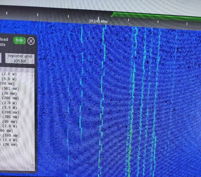

I was decoding WSPR signals on a KiwiSDR web receiver when I noticed a different kind of signal to the left of the cluster of WSPR signals...
The green filter indicator in the black frequency scale at the top shows where WSPR signals are coming in. There is one unknown type of signal just above 10.140 MHz, and another below it.
These signals run at about 1/3 bits per second, which is slower than the WSPR one. They don't seem to be limited to the one-minute time slot that WSPR follows.
What are these and what do I need to decode them?
The signals above and below 10.140 MHz are FSK signals.
You have no scale for the time or the frequency, so I cannot identify the bit rate or the frequency shift. You can extract those details from your data display. You will then need to identify the serial data start and stop, number of data bits and parity etc.
Yes, it is FSK of course. But more specifically, from this article it seems likely that the signal is what hams call "QRSS" .... https://swharden.com/blog/2020-10-03-new-age-of-qrss/ .
It feels like more of a quirky fun mode than a serious way to transmit information efficiently: Most users decode it visually by watching the waterfall, in which the shifted frequency conveys the dots and dashes of GOMC (good old Morse code).
The fact that it is below the WSPR band segment (wspr is another low power mode popular with hams) -- confirms that it is probably QRSS. (See frequency list in the article)Edit:
