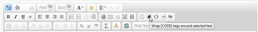

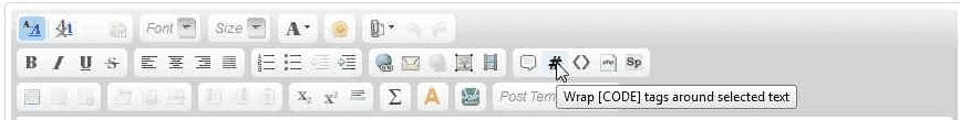

First, when composing a post, you will notice a toolbar directly above the text area, and in this toolbar is a button that will generate [CODE][/CODE] tags:
You can either click that button first, and then paste your code in between them, or you can paste your code into the post content, then select your code, and click the button to have the selected text wrapped with the tags.
This makes your source code stand out and easier to read since white space is preserved, allowing the indentation to be retained. Please edit your post to add these tags. ;)
