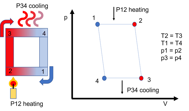

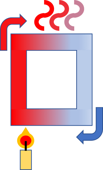

1/ Have a closed hydraulic circuit. Two columns of fluid. One hot, one cold, which are connected at the bottom and top. Let's have small heat loss and small hydrodynamic resistance to fluid flow and incompressible fluid.
I heat the lower interconnection, I cool the upper interconnection. I have constant flow, constant temperature difference.
I need a heating power P0 to heat it.
There will be a flow of liquid. The movement is caused by the different density of the liquid in the hot and cold columns. At hydrostatic head h1, I get some pressure difference that replaces the pump in the system and causes the liquid to flow.
( The above description is a common thing, also used industrially in the past, in natural circulation central heating.)
2/ If I insert a small propeller with a generator into a flowing circuit with hydrostatic head h1 and draw a small electrical power P1. I will call this flow with the inserted device a constant flow Qv (m3/s) and thus supply a constant heating power P0, when the column temperatures are kept constant.
If "n" is a real number, then n * P1 = P0
(It's not our job to build anything right now, so please let's avoid answering that "n" would be a terribly large number. With a column h1=1km high, n << 1000 000. For now, it suffices that some n exists. Let's skip the design "dimensional" issues for now, I'm asking about the principle now.)
3/ At a flow rate of Qv , at a hydrostatic head of 2 * h1 , can I draw an electrical power of 2 * P1 ?
4/ XXX
I don't ask question (4) because usually people stop talking to me. And I would love to know if I have a mistake in the definition of (1) or (2), and I would like to know the answer to my question (3)
... But whoever can answer question 3 will also know the answer to question 4.
I don't see that you defined "n" anywhere, but that probably doesn't matter. The main issue is you don't mention the heat rejection or write a full conservation of energy statement: heat rejection is lower than heat addition if you are extracting mechanical work.

So what you are describing is essentially an external combustion heat engine. I think your description is closest to a closed Brayton cycle.
https://en.m.wikipedia.org/wiki/Brayton_cycle
Using an incompressible fluid is not a good idea, but other than that it is pretty standard.
The propeller is typically called a turbine.

P0 = Pcooling
This is false. These cycles are well understood. They don’t work this way.

That is the correct conservation of energy statement, showing that there is no inequality/"too much energy". The details....well, you'd need to design the cycle. It's not a simple/single equation, you need to analyze the state of the water at every point in the cycle.
Note though that cycles like this usually use low pressure water and steam because just using the density change in liquid water gives almost zero head to drive the flow. If you insist on that, you're sifting through the rounding-error trash that is usually thrown away.
Edit: also, of course you can't simultaneously assume the water is incompressible but changes density. That's an oxymoron. And this is what I mean by "trash": youre looking for excess energy in things that are discarded with simplifying assumptions.

The heating of the fluid is at a higher pressure than the cooling due to hydrostatics. This means that the work done by the heating is higher than by the cooling. This is why Pcool has to be smaller than P0.
A turbine will not cool down the fluid, it will convert some mechanical energy into heat. If you assume incompressibility (due to pressure that is, heat will of course change the density) the turbine cannot have a cooling effect on the flow.

You cannot use the full dp due to difference in rho for the turbune power. Because the system has to overcome a small amount of friction as well.
If you don't include that friction it becomes a problem where you do not need any energy at all to keep the flow going (Newton's first). In that case the heating causes a force imbalance leading to indefinite acceleration, which is not realistic of course.

For an incompressible fluid there is no temperature drop. The efficiency of an ideal Brayton cycle is given by $$1-\frac{T_1}{T_2}=1-\left(\frac{P_1}{P_2}\right)^{(\gamma-1)/\gamma}$$ Since for an incompressible fluid ##\gamma=1## the efficiency is zero, the temperatures and pressures are equal and there is only heat transfer with no work performed.
I think your reasoning is that the difference in density causes a larger difference in pressure if you increase the height. So (rho_hot*g*h1 - rho_cold*g*h1) < (rho_hot*g*2*h1 - rho_cold*g*2*h1), which on itself is true of course.
The thing is that for equal P0 the temperature and therefore the density of the fluid is higher at the hot side if you increase the height to 2*h1. This is because the moment you increase the pressure difference and therefore the flowrate, you decrease the temperature at equal P0. This means the driving force is lower and you do not get exactly 2 times the pressure difference.
But if you have a turbine this of course does not have to be this way. For the first case with h1, you can add a turbine that causes the flowrate to be Qv, but for the 2*h1 case you can increase the turbine size to still get the same Qv. In that case you do indeed get a pressure difference that is twice as large. This would indeed mean that P1 can increase by almost a factor of two, almost, because the plumbing is now longer and you therefore have more friction.
But what also plays a role is that now the pressure difference between the locations where you add P0 and retract Pcool is also twice as high. This means that P0-Pcool is higher and the *net* amount of energy you put in is higher. So then surely you can increase P1 as well.
What needs to be clear is that the amount of energy that you are adding to the system is P0-Pcool, not P0. So with 2*h1 you also input more power.

I don't know if I understand you all. I would like to be clear.
If I have a simple circuit without turbines.
Flow rate 1kg/s
a height of 1km with perfect thermal insulation.
And one column with water has a temperature of 90°C and the other has a temperature of 95°C,
How much power do I need down to heat the liquid and how much cooling power do I need up to cool the liquid.

In order to find that answer, you need to design/solve the whole cycle. I dont think it has a simple answer and I'm skeptical that the way you are using simplifying assumptions will work. For starters:
Point 1: Top of cold column. 90C, 1Bar.
Process 1-2: Adiabatic compression through 1,000 m elevation change.
Point 2: Pressure? Temperature? I don't think you can assume constant temperature through the column. But calculating it and finding out if it is enough to matter would be a good start.
