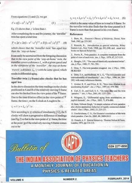

Too short solution of Twin Paradox
Please see in attachment 2 pages which simply solve the paradox.
V S Soni
V S Soni
Patiala India
Thanks for uploading it. I knew you could do it.
Now that I see the original paper, I see what the problem was that I earlier referred to. The problem was that you didn't correctly transcribe from the paper to your post.
Starting with equation (2), you changed t' to t1 and then when you got down to equation (5) where there is a t1, you changed it to t2 which then led to my observation that equation (6) couldn't be right. So your post is all messed up but your paper is consistent.
However, I don't know where you got one of the terms in equation (6):
t2 = t1 + L0v/c2 = L02v + L0v/c2 = L0v = t
Where did you get L0v/c2 from?
You've not proven anything, because you've not looked at the "paradox" part, namely the supposed symmetry of the situation. That is to say, the traveling twin may believe that he did not in fact move at all, and instead A and B and the other twin did the acceleration/deceleration and movement. He may carry the giant ruler with himself, and consider himself the older and wiser twin of the two :p
You have not studied my article properly. See carefully the Thumb nails above.
Vidwan Singh Soni
Your contention that the 'traveler' thinks that he is does not move at all is wrong. An accelerated frame always feel his motion!
V S Soni
Vidwan Singh Soni
Maybe not but I'm asking for help. I cannot see any prior reference to your term L0v/c2 until it pops up in equation (6). I don't doubt that the equation is valid, I just don't understand where you got that term that makes it valid.
V S Soni
If you haven't already seen http://math.ucr.edu/home/baez/physics/Relativity/SR/TwinParadox/twin_paradox.html, you may want to give it a quick read - you're misunderstanding the point of the paradox.
There are acceleration-free ways of constructing twin paradox situations: For example, you can have the traveler turn around by doing a tight hyperbolic orbit around a massive object; the traveler will remain in free fall for the entire journey, just as does the stay-at-home twin. In that case, there is absolutely no basis for claiming that one of the twins is moving and one isn't.
For that matter, there doesn't have to be any turnaround at all to construct the paradox. Suppose that the outgoing traveler never turns around, keeps on flying away forever. However, at some point on his journey he encounters an inbound spaceship traveling in the opposite direction; and as they pass the inbound traveler sets his clocks to whatever the outbound traveler's watch reads. When inbound meets up with stay-at-home, how do their clocks compare? And how do you reconcile this result with the fact that at every point in the journey, the travelers correctly found that stay-at-home's clock was slow because of time dilation; yet stay-at-home correctly says the same thing about the traveling clocks?
