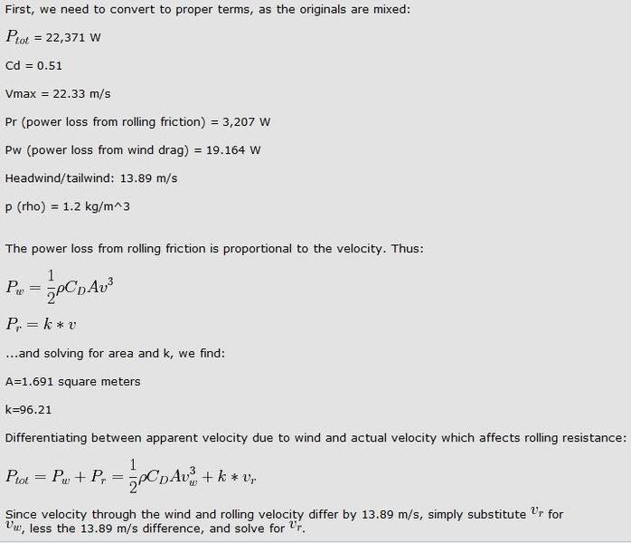

I'm not sure the OP is applying k*v for rolling friction. The main point is that a headwind will slow down the car's road speed by direct subtraction.

The parameter you are missing is the speed. The wind might be 135km.h, but the car is still only moving at 75km/h through it.
The force trying to slow the car might be the same, but the car is moving much slower against this force...hence why it has power to spare.
I calculated that the air drag against the car from a 135km/h wind is about 850N.
So, plugging this into the power formula...
p = f x v
p = 850N x 37.5m/s
You get 32000 Watts. 43 horsepower. As you said, about 40% more power.
The issue, though, is that 37.5m/s. Remember, that's NOT how fast the car is moving. It's only moving at about 21m/s, because it's applying it's power against the stationary road, and not, like an airplane, against the air.
p = 850N x 21m/s
About 17850 Watts. 24 horsepower. 3 horsepower off from 27...just enough to account for road drag and whatever other uncertainty...
The motor does not make more power or torque in a headwind. It develops power according to the torque speed curve. For simplicity, at constant speed, let there be 1 power source and 2 power sinks.
Pin = P1 + P2
where P1 is power dissipation due to friction in the driveline. If this depends on velocity (reasonable) then in a headwind in 3rd gear the driveline is turning only in proportion to 75km/h versus 120km/h in static air in 4th gear. The simple answer is P1 is lower in the headwind making more of the limited engine power available as P2 to push wind at 135km/h equivalent relative velocity.
In no case should the car be able to push air with more power than the engine makes, so if your aero model and engine curves show violation of conservation of power, one of them is wrong! But here I see no reason to doubt your models on the face of it.

Since my explanations were ingnored, I'm just directly going to answer the above question: NO. You DO NOT need the same power.
... The main point is that a headwind will slow down the car's road speed by direct subtraction...
THIS is NOT TRUE
If you have a backwards wind of 50km/h, driving at 70km/h will only require 15hp. Therefore, that WILL NOT be your top speed.
If you have a backwards wind of 100km/h, driving at 20km/h will only require 4.3hp. Therefore, again, that WILL NOT be your top speed.
Let's take it all the way. If you have a backwards wind of 120km/h, you only need 0hp to drive at 0km/h. Therefore, that will also NOT be your top speed.
And it's very easy to see why, using simple high school mechanics formulas. You can do the calculations to check it out yourself, but you MUST use the correct valuves, which you have NOT been doing. I have already done the simple calculations in this thread, and they work out.
Just two simple formulas:
force (air resistance) = ½pCdAv[tex]^{2}[/tex]
Power = force x speed
The v and the "speed" are NOT the same. The v represents the wind speed, the "speed" represents the road speed.
If you solve these formulas, you will see that a 120km/h wind only gives a force on your car of like 575N. This means that my wife could push your car against 120km/h wind. The only question is how fast can she push it.
RIGHT! But without stalling or seriously loading down the engine, she could not drive it in 4th gear! She probably could not drive it in 3rd gear! She maybe could drive it OK in 2nd gear and probably could crawl along against the 120 km/h headwind in 1st gear at the rpm in which the engine power is exactly matched to the reflected torque from the drag force and driveline friction! The tire radius and gearbox are a source/load transformer and if you don't properly model this function you won't be able to identify the torque/power equilibrium condition in the differential equation of motion.
Right...with a 120km/h headwind, you're probably not going to go anywhere in 4th gear.
With 30 hp, this car could theoretically go against this wind at around 58km/h...although probably less due to gearing constraints.
Great ! now numbers and tests results match together !
I still have some deviations but they are really small and probably due to my way of doing the tests.

A couple things I noticed about your test and calculations though...
First, you said you were driving into a 60km/h headwind. There has to be some large inaccuracy there because I doubt you have a pitot tube in your car...
Second, a car usually loses power between the engine and the wheels. I keep hearing around 15%, which means your car would only have 25.5hp with which to propel itself and fight the wind and the rolling resistance. I'm not sure how that would affect the results.

So my model confirms Lsos' basic analysis. I misread your post above since you said the engine would require 43 HP (my bad). Now I see the point you were making. The graphical comparison is attached.

  • #31
Hi System Theory ! That is great ! I really thank your plots.
Where did you get that car front area?, I coldn´t find any document with this parameter. I solved my myself by a home made method to get 1,67 m2.
Where I live the mean air density is 1,15 kg/m3.
Thanks again for your good job.
  • #32
I guess you did do some proper tests then!
CHICAGO said:
About the engine power, I understand it is measured at the clutch flywheel and the gearbox losses are included in the rolling resistance, am I right?
You are right that engine power is measured at the clutch. However, the drivetrain losses are NOT included in the rolling resistance.
Rolling resistance is generally constant, no matter how fast you're going. As a result, power lost due to rolling resistance rises linearly with speed. If it's 4.3hp at 120km/h, then it will be around 2.2hp at 60km/h.
Drivetrain losses, while being complicated (dependent on rpm, torque, engine type, drivetrain layout, transmission, etc), is generally said to be 15% of engine output for a front wheel drive, manual car. Notice that unlike rolling resistance, it's not dependent on speed. This means that for your car, the actual power getting to the wheels is only about 25.5hp. So you have 25.5hp to overcome air drag AND rolling resistance.
I hope this doesn't mess up your calculations too bad. Whatever calculations I did were also ignoring drivetrain losses. And, I was using 1.69m[tex]^{2}[/tex] as the car frontal area, which I deduced from your calculations...
  • #33
Frontal area Af = 1.8{m^2} was an estimate based on a modern (199?) CV2 design that I saw in a website or the Wikipedia. If you provide some more system parameters I'll revise the model to your values.
I can overlay the source transformer force-velocity curves on the drag loads in these plots if you provide a sketch of the torque-speed curve, the tire radius, and the speed reduction ratio in each gear. How did you estimate or measure the torque-speed curve?
