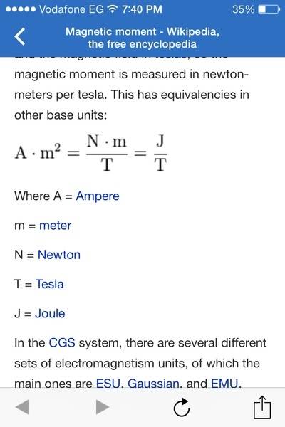

Wikipedia says that the unit of magnetic dipole moments is calculated by Joule/B that means that the torque is measured by joules
I really doubt that, it seems non sense.
I'm not seeing that (I'm seeing n-m), can you link and quote it please.
