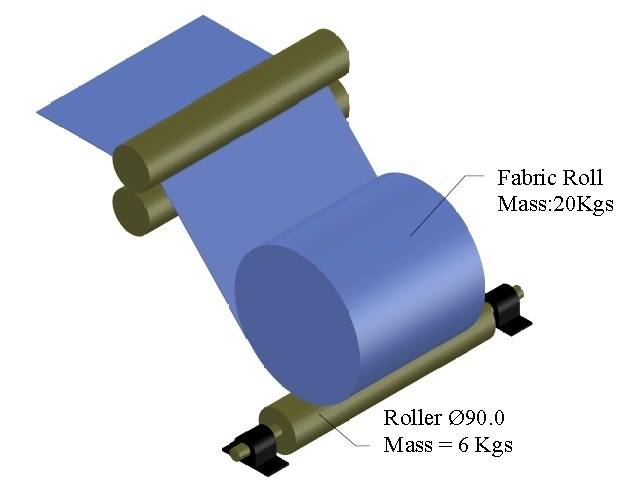

We’ve a roller of length 400mm & Dia of 90mm. At both ends of the roller a shaft is fitted. Shaft dia is 25 mm & length is 100mm each side. On the 25mm Dia shaft, two flanged bearings are fitted. The total roller & shaft weight is 6 kgs.
Working Principle:
Over the roller, a fabric in a roll form is loaded. The fabric roll sits over this roller by means of gravity. The roller has to drive the fabric roll on its circumference & feed the fabric end to another machine.
Problem:
1. What is the torque required to drive the roller at the shaft end.
2. What HP of motor, we should select to drive the shaft, if the motor is directly connected (without any gear box) to the 25mm dia shaft

@Billy_joule
Power = torque. Angular velocity
Torque = radius . Force
Force = mass. Acceleration
Acceleration= velocity/time
Velocity= radius. Angular velocity
Angular velocity = (rpm.2.pi )/ 60
The roller needs to run @ 10 rpm.
Using the above formulas I've calculated this.
Hence angular velocity= 1.05 rad/secs
Velocity = 0.045 x 1.05= 0.05 m/secs
Acceleration= 0.05/3 = 0.02 m/sq.secs (0 to 10 rpm in 3 secs)
Force = (20+6).0.02x 9.8= 4.0 N ( 20 kg fabric roll, 6 kg roller self weight )
Now torque= 4.0 x 0.045 = 0.18 N.m
This is the calculation I've done. Not sure its right. I cannot attach a picture of the setup. Perhaps a drawing i can attach
attached a conceptual drawing
This is a cinceptual design

These calculations are all correct.
It's a little strange that you specified the rpm and not the tangential velocity. I would've expected you to need the fabric to be fed at a certain rate as that is the entire purpose of the machine. 5 cm of fabric per second seems mighty slow to me, but then again you haven't told us the purpose of the machine... Why did you select 10 rpm? Why did you select 3 seconds? why not 6? That would half the motor cost/size/energy use..
These are wrong.
The weight of rolls acts through the center of rotation so the 'r' in the T=Fr equation is zero. That is to say they make no contribution to torque about the shaft.
You need to calculate the moment of inertia ('I') of the rotating masses.
http://en.wikipedia.org/wiki/Moment_of_inertia
Then you can calculate the torque required for the acceleration:
http://en.wikipedia.org/wiki/Angular_acceleration
But what you are really need to know is the steady state operation- how much power you need to keep the motor turning at your target rpm. for that you need to know where energy is going (eg the opposing torques from friction etc); not a trivial task.
EDIT: I now see your design. How does it compare with other similar machines?
Many people have invested millions of dollars and man hours in designing machines just like that...Do you think you'll compete with those designs? Why do you want to reinvent the wheel? Why not get (or copy...) an off the shelf design with years of R&D already done for you?

Re; post #13.
As the fabric unrolls at a set speed determined by the bottom roller, it rises up between two other pinch rollers.
Fabric cannot be pushed uphill, so it must be pulled up by the two pinch rollers. All the work of moving the fabric must be done by the upper pinch rollers. The bottom "driving" roller is not driving and will therefore not require power.

Mechanisms to pull sheet or tape off rolls can be found easily. Powered pinch rollers are used. a single roller can be used if the wrap angle and friction are sufficient.

The bottom line is that you need to pull the sheet off the reel.

Fabric cannot be pushed up through unpowered pinch rollers. See post #16
