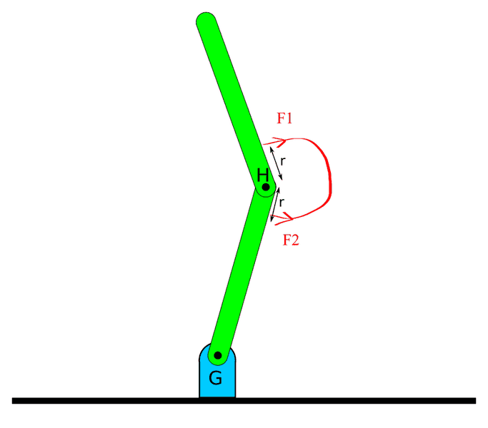

In the following figure we have two rods connected to each other, and the bottom rod is connected to the blue structure (G), and G is connected to a large immovable object. The rods can rotate around point H, and the bottom rod can rotate around the joint it creates with G.
Assume that the rods are of equal length, and are uniformly weighted.
Suppose gravity doesn't exist for the purposes of this question.
There is a muscle fiber that connects the rods. My question is this:
When the muscle fiber contracts, and exerts tension at the attached points on both rods, what happens to the system? In particular, what happens to point H? Assume F1 and F2 are directed perpendicular to each rod, and are of equal magnitude.

I understand that if these two segments weren't connected to G, then one could calculate the position of point H by taking advantage of the fact that the centre of mass does not change, since all the forces are internal. In that case, you would first calculate the centre of mass. Then you could calculate the torque, due to each force around point H, calculate the angular acceleration of each rod around point H, and then using geometry, one could figure out where point H is as the rods rotate around point H, since the centre of mass does not change.
But in the illustrated example, I don't think things are as straightforward.
F1 creates a clockwise torque in the top rod around H.
F2 creates a counterclockwise torque in the bottom rod around point H
F2 also creates a clockwise torque in the bottom rod around G.
And this is where my mind gets stuck. I'm not as interested in the precise answer, as I am in understanding how to approach such a problem. I'd like to be able to learn how to think about this sort of problem, and would appreciate and guidance.
You describe the connecting string as a muscle fibre. The forces shown on the fibre clearly do not balance, so the fibre must also be in contact with something else. In the obvious interpretation of the system as an arm, that something would be connected to the joint H, not to the ground. That being so, there is a force leftwards on H.
G exerts an unknown force on the mechanism, but no torque. It follows that there can be no angular momentum change. If the two rods are the only masses, they must have equal and opposite rotation at all times.
Can you figure out from that how the rods move?
Ah, my error. If I'm understanding correctly, to depict them as balanced, the forces must be parallel to each other if they are equal in magnitude, and in my illustration they are not parallel.
No, that wasn't my point. The muscle fibre itself must be in balance, but you only show the two forces on it. In practice, there must be another force to the right from the middle of the joint onto the muscle.

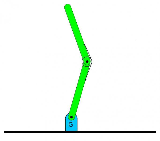

suggests to me that you model should look more like this...
Yes, that is more accurate. I wanted to abstract the situation into a toy problem. I like your rendition better as it allows the depiction of the contractile element (muscle fiber) as a straight line. Thanks for taking the time and effort to modify the image.
In your version, I take it that the angular momentum of the system still can't change, but that because there is an asymmetry in the mass distribution between the two rods, the rate of rotation of each rod won't be equal and opposite as they were before. Would your rendition create any other important differences?
I didn't mean to change the mass of either rod. They could both still have the same mass and moment of inertia if you like. You could also draw it with two identical rods and a torsion spring at H (http://img.directindustry.com/images_di/photo-g/15174-2439519.jpg) The point is that a the muscles create a torque between the two rods at point H.
Understood, and I like the torsion spring idea.

Yes. If you consider your original diagram from the muscle's point of view the only forces on it go to the left. Clearly there must be another force on it. The only place that force can come from is the joint, which means that the muscle is exerting a force to the left on the middle of the joint.
Anyway, CWatters' redrawing of the muscle as a straight line gets around the problem.

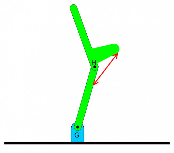

So muscle fiber pulls on rod in a rightward direction (green arrows in my drawing).
In reaction to this, the rod pulls leftward on muscle (not shown).
This reaction force would cause the muscle to accelerate to the left (just as if I pulled on something, i'd pull myself towards it).
The fact that the muscle isn't accelerating towards the rod means that the rod must be counteracting this acceleration. Doesn't this same situation apply in Cwatters' version?

In CWatters' drawing, there are two equal and opposite forces on the muscle.
