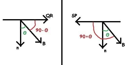

Revered members,
please see my attachment (1)
In this diagram, PQRS is a rectangular current loop and I is the current and its direction is shown in red arrow . B is the magnetic field and it acts from left to right and n is the normal drawn to the plane of the loop.
[itex]\Theta[/itex] is the angle between normal to the plane of the loop and the direction of magnetic field.
I have to find the angle between I(QR) i.e current element and B, similarly angle between I(SP) and B
In the book angle between the I(QR) and B is given as (90 - [itex]\Theta[/itex]).
similarly angle between I(SP) and B is given as ( 90 + [itex]\Theta[/itex])
since n is normal to the plane of loop, angle between n and SP (and ) n and QR is 90 degree.
so if angle between n and B is [itex]\Theta[/itex], angle between B and SP (and) B and QR should be 90 - [itex]\Theta[/itex] so that when i add
90 - [itex]\Theta[/itex] + [itex]\Theta[/itex] i will get 90 degree which is the angle between normal to the loop and concerned current element.
But my teacher says what is given in the book is correct. Where do i go wrong? Please help revered members. Thanks in advance
