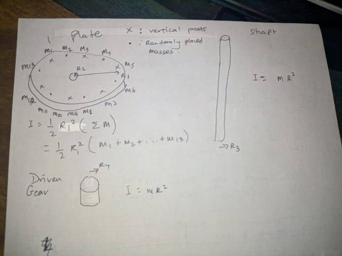

Thank you for your answer once again. I have attached an image below for the derivation, sorry for the uncleanliness btw. Should i also take into account the driver Gear also?
Let's suppose i get Total Moment of inertia as 100kgm^2. What do i do next?
Thank you for your guide dear friend!
Yes, just start at the pinion and work your way out from there.
Note, be careful with the gears (they have related but different angular velocities). You are going to have to relate them to the angular acceleration of the table when accounting for their moment of inertia.

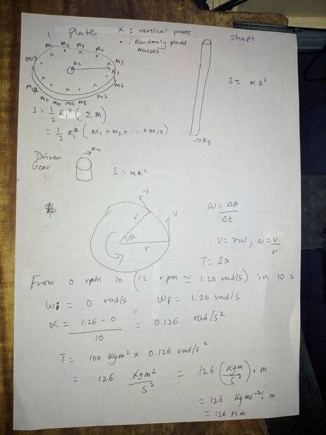

After that you need to determine an acceptable angular acceleration for the application. Just pretend you want the angular acceleration to be constant ( I won't be in reality, but we are just aiming for an upper bound at the moment)... This thing is rotating fairly slowly. Maybe you can accept this turntable taking 2 full rotations to get up to full speed, maybe 4 ? from there what kinematic relationship would you apply to determine ##\alpha##, that involves ##\omega, \theta##?

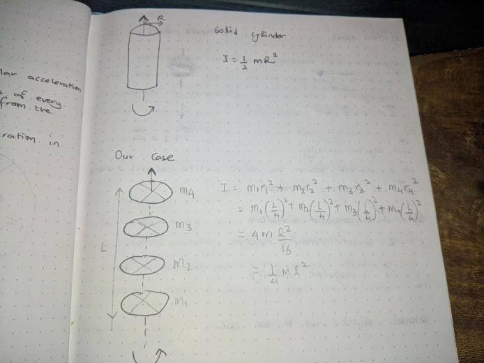

I have attached the image please check it if it is right. And also i didn't take into account the driver Gear into consideration when deriving the moment of inertia of the whole system. I suppose it is not important, am i right?
And are the calculations i sent initially for the chain traction force etc, should i still take that into account for the motor sizing?
Thanks in advance

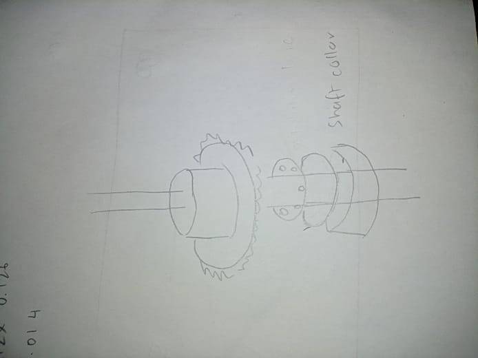

Hello there, actually the system being built should be able to to stop at 4 positions minimum, you can see on top of the rack i have divided the sections from A to F. But in actual system the discs will be divided into 4, i.e A to D. So i will be using a stepper motor for that. Upon building the prototype and testing it that i will know if 20 to 24 rpm is acceptable. This is why i chose a safer option of 12 rpm which is relatively slow.
And for the gravity induced misalignment, the sprocket on the motor shaft will be fixed with set screws, but i can also use a little shaft collar to prevent that from happening.
And the driven gear can also use a shaft collar and a thrust bearing to minimize the friction between the sprocket and shaft collar. I have made a little freehand sketch to picture what i am trying to say. I don't know if that makes sense, i don't have much experience in this subject i am still a beginner.
But how would you size a motor for that system?
Thank you for your help.

A couple of points;
a) To find the torque needed to make the system run at a constant speed, you need to know the frictional losses in the bearings and the chain. This torque could be a lot less than the torque needed to accelerate the system (assuming everything is well lubricated!). So when acceleration is complete, the torque will need to be reduced to keep the speed constant. Or maybe (as suggested by @Lnewqban) you could find a motor which settles at a constant speed.
b) You appear to have calculated the total moment of inertia to be 100 kg m². That can’t be right considering the total mass is only a few kg and the radius is 0.3m!
Likes Aaron Mac
Steve4Physics said:
A couple of points;
Thank you for your answer, I just took the inertia value at random for as an example. Even when overestimating some parameters the Total moment of inertia doesn't even reach 0.2 kgm^2.
Likes Steve4Physics
