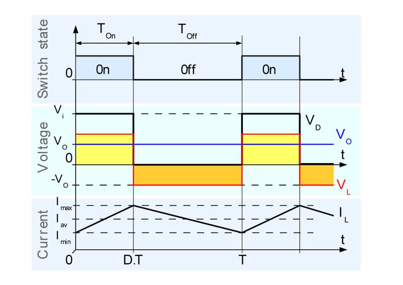

metastable said:
4.347826% duty cycle
Umm...
That motor is going to be coasting during the 95% off-time and may even be back driven by the other motor.
With the open source VESC based controllers in duty control mode, during each commutation cycle the controller functions as a buck converter in continuous mode so the current through the inductor (the motor windings) never falls to zero during the commutation cycle. (The inductive windings are shorted to themselves during the duty off time and the current flows inductively. Switching speeds are on the order of 20khz)
https://en.wikipedia.org/wiki/Buck_converter
"Buck converter operates in continuous mode if the current through the inductor (
21184bdc344826fe83f82f4a68e49bea172a1d86
) never falls to zero during the commutation cycle."
^The motor current in the energized windings during one commutation cycle looks like I-avg
Likes Tom.G
