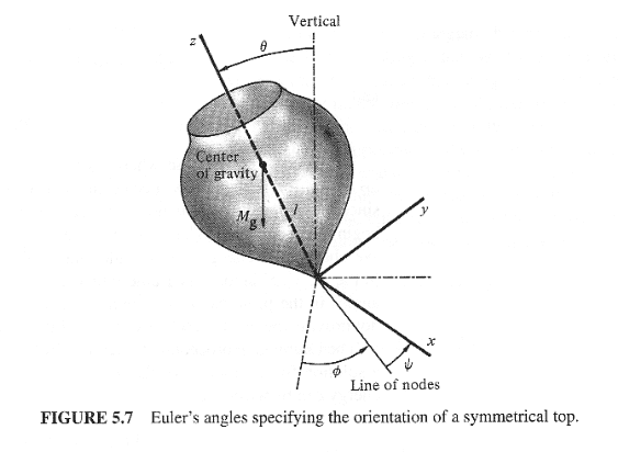

Torque ##\tau## should be in the same direction as the change in angular momentum ##\Delta L##, but the following example seems to suggest otherwise.
Consider a cone rolling on its side without slipping on a flat surface. Let the apex be the origin and the initial coordinate of the center of mass (CM) of the cone be (-a, 0, c), where a and c are positive constants. (That means the cone, or rather its projection, is in the middle of the 2nd and 3rd quadrant of the x-y plane.) The cone rotates anticlockwise about the z axis. So, when viewed from the apex to the base, the cone rotates anticlockwise around its symmetry axis. That means the angular velocity ##\omega## and hence the angular momentum ##L## points in the +x direction, if we ignore their z components.
At this instant, the CM of the cone will move in the -y direction, making ##L## point into the first quadrant in the next instant. Thus, ##\Delta L## is in the +y direction.
Since the CM moves in a circle, there must be a friction ##F## to provide the centripetal force. Thus, at this instant, the friction acts in the +x direction. The fiction acts along the line of contact, which is vertically below the CM. So the torque ##\tau=r\times F## about the CM is in the -y direction, which is opposite to ##\Delta L##.
What's wrong?

I found that the angular momentum precesses about the z axis unless ##h=\frac{\sqrt{3}}{2}r##, where ##h## and ##r## are the height and radius of the cone respectively, in which case the angular momentum remains constant. But I can't make sense of this result.

The mistake is that we cannot take torque about the center of mass but take the angular momentum about the apex.
We have to take both of them about the same point. In this case, it's easier to take them about the apex. We know ##\Delta L## is pointing in the +y direction.1 So ##\tau## must too. There means the line of action of the normal reaction force and that of the weight of the cone cannot meet. The former must be further away from the apex to create a net torque in the correct direction.
1Post #1 obtained this result by ignoring the z component of ##L##, but it can be shown that the z component is constant.
I made a mistake1 in my calculation and hence it produces a nonsensical result. The angular momentum should always precess about the space z axis.
1I forgot the negative sign in ##\dot{\phi}=-(\sin\alpha)\,\dot{\psi}##, where ##\alpha## is the half-angle of the cone.

I would say the problem is most easily analysed from the apex point of the cone. For the sake of the discussion, let look at the moment the cone is in the x-direction from the apex and that it is rolling into the first quadrant. In this situation, there are two contributions to the angular momentum, one coming from the overall movement of the cone into the first quadrant, which gives an angular momentum in the z-direction, and then the rotation of the cone about its axis, which gives an angular momentum in a direction which is pointing in the same direction as the cone axis, i.e., with negative components in the x- and z-directions. Overall, we have a z-component and a negative x-component. The z-component is obviously conserved during the motion (as long as it is with constant angular velocity), and the other component will precess around the z-axis.
So what are the torques around the apex? The frictional force has zero torque as its line of action is through the apex, the normal force from the table on the other hand gives a torque in the negative y-direction, which is perfectly compatible with the component of the angular momentum perpendicular to the z-axis (being in the negative x-direction at the moment we consider) precessing around the z-axis.
Of course, you could really do everything by actually doing the math, but it would involve the inertia tensor of the cone and I do not think it would add much apart from the math being consistent.

I think the confusion is a problem with the coordinate system. If you consider torque around the center of mass, you have to take the non-inertial motion of the center of mass into account - your reference frame is accelerated. That makes the analysis messy, and you probably need fictional torque or something like that.
Likes Happiness
For some reason, you omitted the torque due to the weight of the cone, about the apex. Since the weight and the normal force are equal in magnitude but opposite in direction, their torque would cancel each other if their lines of action are the same distance away from the apex. Thus, I was led to deduce that the normal force must act at a point horizontally further from the apex than does the weight.

Yes they are not the same. Perhaps I should have added an explanation when I put in the picture of a gyroscope. The picture is to define the Euler angles ##\phi##, ##\theta## and ##\psi##, which are used in my calculations. It is not to suggest that a rolling cone is a gyroscope.
It should. The idea is the same as a braking or accelerating bicycle: the circular motion with its corresponding acceleration leads to a stronger normal force on the outside.
