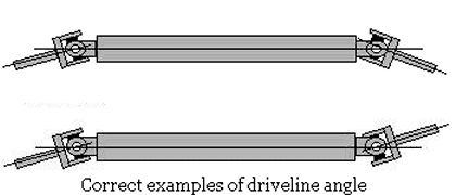

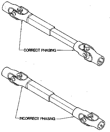

I mentioned driveshafts because hookes joints need nearly identical angles or the driveshaft will whip in a twisted motion. Besides that Hooke's joints have an oscillating velocity that is proportional to the working angle.
If the velocity changes as the joint speeds up and down the load torque should oscillate as well. A driveshaft at a bad angle would seem to cause a fluctuating load. This is bad for smooth clutch engagement perhaps.
When considering a hookes joint the torque transmitted through it and the changing speed result in fluctuating power in the physics sense of it. Is that right, wrong?
So called constant velocity joints of the tripod or rzeppa type probably have better angularity tolerances. Tripod type are not true constant velocity I think.
This is most likely the problem caused by engine mounts that are too soft.
All Hooke's joint angles are «bad» angles, in the sense that input/output speed start varying as long as it is not equal to 0. This is not a problem when you put 2 Hooke's joint together (in the correct phasing) and run them at the same angle: The variations cancel each other out and you get a constant-velocity assembly. But if your engine mounts (as well as your suspension mounts) are so soft that you cannot keep both Hooke's joint at the same angle, then you will get torque variation that will translate into wheel hop of difficult clutch engagement.
Thanks Jack,
The suspension design of some rear wheel drive vehicles I have looked at with trailing arms on both sides has an interesting effect.
It causes the rear axle to rotate as the suspension travels so that the nose angle at the pinion shaft changes symmetrically with the joint at the driven end.
If there is too much play in the mounting its conceivable to me that the front joint would go out of matching angle.
Or as youve said, if the rear suspension doesn't hold the axle horizontally- the trailing arms handle the sort of vertical or axial alignment.
Thats how it seemed anyway. The driveshaft angles have to match even when the vehicle is heavily loaded with a trailer for example.
