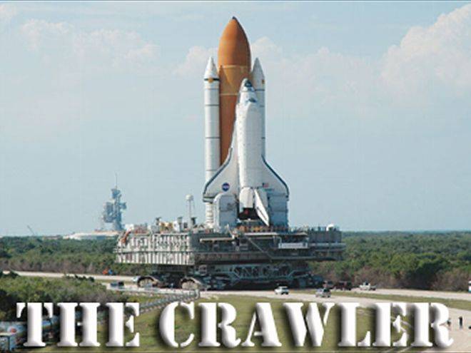

Stephen123 said:
Mass = 400t.
I think the Space Shuttle and empty external fuel tank are about 200 tons (with a quick Google search). I guess you should study the design of "The Crawler"...
http://image.trucktrend.com/f/91045...00-hp+nasa-diesel-shuttle-crawler+shuttle.jpg
Likes russ_watters

Did you see my post? Did you look into The Crawler to see what its acceleration and top velocity are? Why do you think you can do this with electric motors and small wheels?
