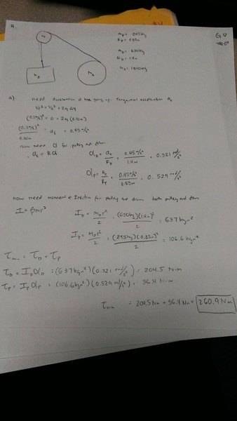

1. Problem statement
A simple model of a crane involves a motor driven drum that winds or unwinds a steel cable onto the drum. The cable passes through a pair of guides and over a pulley at the end of the crane arm. Ignore the mass of the cable in your calculations. The drum has a mass of 650kg and a 1.4m radius. The pulley has a radius of 85 cm and a mass of 295kg. The load has a mass of 1800kg.
a) if the load is to be accelerated from rest to a constant lifting speed of 30cm/s over a distance of 10cm, what minimum torque must the motor provide?
b) what minimum amount of energy is required by the motor to lift the load from rest to a final height of 10m where it ends at rest?
c) what are the tensions in the section of cable from the drum to the pulley, and from the pulley to the load as the load is accelerated? What are the tensions when the load is lifted at constant speed?

3. Attempt at solution
For part a) what I did so far is I know there is a linear tangential equation that the load is lifted at a distance of .1m which I solved using Newtons kinematic then I converted that to a rotational acceleration by dividing it by the radius of each of the pulley and the drum. Which gives me two different alphas, I then find the moment of inertia for the drum and the pulley which then I can find the torques for each. So since I found the torques do I just sum those up and it will give me the minimum torque needed? But my question is how do I count for the mass of the load? Or is my answer correct?

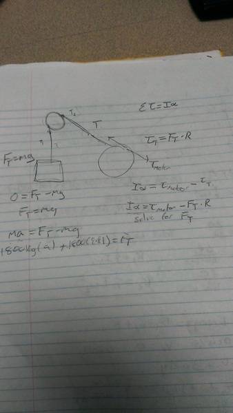

Part c) I know the tension from pulley to the load is the easy part since I'm just summing up the forces in the y direction when there is an acceleration or not , but from the drum to the pulley, do I just apply the summation of the torque ( when being accelerated ) is I(alpha) = torque(motor) - torque(tension) where torque(tension) is equal to Ft*r and just solve for ft since I have found most of the values already.
Try answering this first: if the pulley and drum had zero mass, how would you calculate the torque need to accelerate the load?
The torque needed at the drum to accelerate the drum is easy - you've done that.
The torque needed to accelerate the pulley is a little more subtle. Remember that the drum doesn't 'know' anything about the pulley. All it knows is the tension it has to generate in the cable. So the torque needed at the drum to accelerate the pulley may be different from the torque needed at the pulley itself.
One way to make this all very clear and straightforward is to introduce unknowns for the tensions (different ones for load to pulley and pulley to cable) and do the usual free body analysis on each of the three.

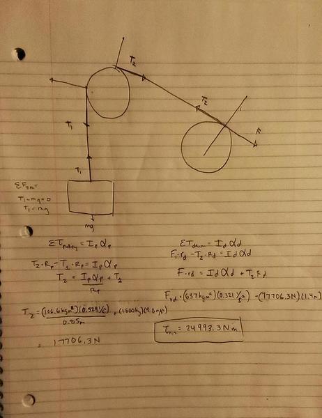

So what I did is I drew a free body diagram for the load, the pulley and the drum.
for the summation of torques at the pulley it had two different tensions, I labeled T1 as the tension from the load, and T2 is the tension from the drum, which looked like
Ʃ[itex]\tau[/itex]pulley = Ipulley[itex]\alpha[/itex]pulley
T1Rp + T2Rp = Ipulley[itex]\alpha[/itex]pulley
(Rp = radius of pulley)
both tensions are positive because both are rotating in the clockwise which I labeled as the positive direction. Then I did some algebraic maneuver to isolate T2 by itself.
Then I drew a summation of forces for the drum, I'm thinking since there is a force needed to rotate the drum in the clockwise direction in order to pull the load(which I think is the torque that I am looking for), would that mean that there is a T2 pulling the drum to turn in the counter clockwise direction (or negative direction).. so that gives me
(Rd = radius of drum)
Ʃ[itex]\tau[/itex]drum = Idrum[itex]\alpha[/itex]drum
FRd - T2Rd = Idrum[itex]\alpha[/itex]drum
and then I just do some substitution and move around some terms and solve for the F? or maybe that FRd term is just an unknown [itex]\tau[/itex] term that I just solve for?

If FRd is the torque you're trying to calculate, yes.
I think I made a mistake in one calculation of the pulley, the tension from the load is opposite of the tension by the drum meaning they would be different in signs correct? this is my work I have so far..
which I think seems right

T1 is not equal to mg. The load accelerates too. Once you've corrected that you will get the right answer, but by sticking with symbolic algebra a bit longer there's a numerically simpler way. If the cable's acceleration is a, and it runs over a uniform cylinder radius r, then the angular acceleration is a/r, the MI is mr2/2, the torque is amr/2, and the difference in cable tension needed to generate that torque is (amr/2)/r = am/2. So it turns out that the pulley's radius is not relevant.
I see, I just adjusted the T1 = mg + ma with the tangential a I found because it seemed simpler to me, haha. is my theory for part b correct though?
