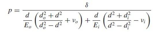

My problem is relating to torque transmission through a press fit connection. Basically, I have a design that works and transmits the torque required of it; the design is, however, over-engineered and I wish to optimise it. I wish to be able to specify a torque (say 60Nm) and from that be able to mathematically determine a length of press fit required to transmit that torque.
Step 1.
I believe there are three steps required to reach to get there. The first step requires to determine the contact pressure at the press fit connection. Because there are tolerances on the components, there will be a maximum and minimum pressure. Currently the tolerances on the components are fixed, and I can not change them. The formula I'm using to calculate the pressure is one I've seen referenced in several books and on several websites. The formula I'm using is:
Where:
Vo = Poisson’s ratio of hub = 0.292
Vi = Poisson’s ratio of shaft = 0.292
Dhi = Hub inner diameter = 108.5mm
Dho = Hub outer diameter = 113.0mm
Dsi = Shaft inner diameter = 62.0mm
Dso = Shaft outer diameter = 108.5mm
Eh = Hub elastic modulus = 210000 mpa
Es = Shaft elastic modulus = 210000 mpa
Delta = Size of interferance = 0.119
There is also an excel based online calculator that uses the same equation at:
http://www.meadinfo.org/2009/07/press-fit-pressure-calculator-optimize.html
Using the above formula and values I calculate the pressure (P) to be: 8.475 N/mm^2. Which is also the same answer -- minus rounding errors -- that the excel based calculator gives me.
This leads me to believe that step 1. is the correct approach. Any input would be apprecaited.Step 2.

Nidum said:
Deleted pro tem
I think the first equation covers this? It's requires outside and internal diameters for the two components that make up the press fit.
Interface shear stress = radial stress * coefft. friction .
Break away torque = interface shear stress * circumference * shaft radius * length of engagement .
Numbers : Break away torque for a 1 mm length = 8.475 * 0.4 * 108.5 * pi * 108.5/2 = 62695 N-mm .
Your applied torque = 60000 N-mm .
About the same . So about 1 mm engagement gives break point between holding and breaking away .
Now factor that by about 25 for a safe design !

Nidum, thank you. Not only is this a thorough reply but a speedy one, too.
So I was on the right lines then?
The equation I used in Part 3 is the same as 'Break away torque = interface shear stress * circumference * shaft radius * length of engagement'
I was just shocked that it was giving me such a small value. As well as a press fit, the connection is bonded with locktite. But I just wanted to be able to mathematically determine my limits. The shaft is also subejct to a bending momnet, and I hope to be able to factor that in as a next step. But I first wanted to get to the bottom of the press fit torque transmission. I guess I will just have to accept the results of 1mm?
Yes - your answer was correct .
