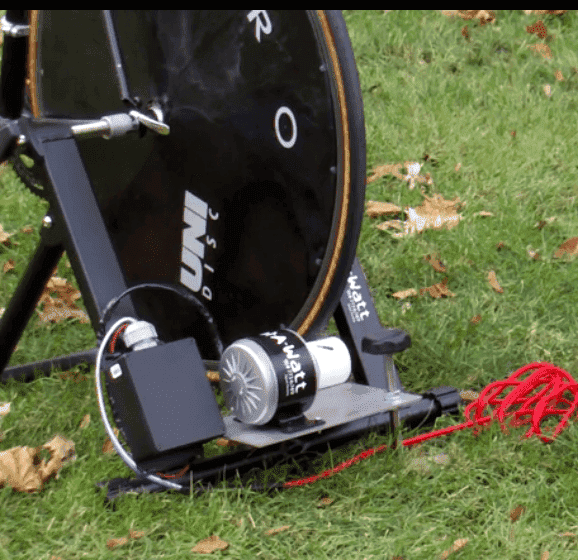

Have a general question about torque. I have a 102 inch diameter, ring shaped, flywheel that weighs 500 pounds. It is rotating at 25 RPMs. I know that the energy produced is 1304 joules, but you need to know how many Nm that equates to.
Second question: this flywheel is placed in a direct-drive configuration with an arbor or shank of a generator. If the flywheel is producing 961ftlbs of torque, how much of that torque is being transferred to the 2" diameter cylinder that is turning the generator? See the picture for clarification. The bike tire would be my flywheel and the smaller PMG would be my generator.
I can't see the picture. Might be the tablet I'm using.
Ok can see the picture now.
The torque is reduced by the ratio of the diameters so it would be 961 * 2/102. The rpm would be increased to 25 * 102/2.

I've run some numbers...
For a hoop/ring with all the mass concentrated at the circumference the moment of inertia is given by
I=MR2
The energy stored in a flywheel is..
E = 0.5Iw2
where w is the angular velocity
Substitute for I..
E = 0.5MR2w2
I work in metric so..
500lbs = 227kg
102" = 2.6m, R = 1.3m
25rpm = 2.6 radians/sec
E = 0.5 * 227 * 1.32 * 2.62
= 1297 Joules
That's close to your figure of 1304 Joules.
If your generator needs 20ftlbs at 25*102/2 = 1275rpm then the power required can be calculated..
20ftlbs = 27Nm
1275rpm = 134 radians/sec
Power = Torque * angular velocity
= 27Nm * 134 rads/sec
= 3618W (3.6kW)
You can calculate how long the flywheel will turn the generator on it's own...
Power = energy/time
so
Time = Energy/power
= 1297/3618
= 0.35 seconds
Unless I've made a mistake the flywheel will stop really quickly.

I have an engine that is producing 600ftlbs of torque at 25-30 RPMs. The engine surges-its inherent to it's design. We want to add a flywheel to smooth out some of the surging and to capture some of the torque as well. So we decided to direct drive (via outside perimeter of the flywheel) the generator off of a flywheel (102" diameter, 500lbs, 25-30rpms).
We need 20ftlbs of torque at 1200 RPMs to get the Kw we need out of the generator.
Can you run a smaller flywheel on the generator too? As a separate flywheel ?
Ah ok that makes things clearer but I see a bit of a problem...
The available power (600ftlbs at 25-30rpm) works out at 2.1 to 2.5 kW.
The power required to turn the generator (20ftlbs at 1200rmp) works out at 3.4kW
So your engine isn't powerful enough to do the job by >1kW. A flywheel designed to run at a constant speed can't solve this.
You could use a variable speed flywheel but it would be quite a challenge to make one and potentially dangerous in operation. How long would it need to deliver the missing 1kW for?
Perhaps you can live with a lower power output?
