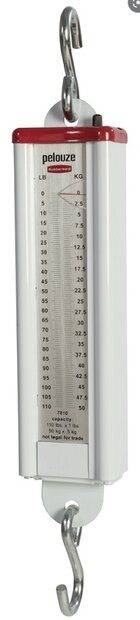

I once designed a threaded connection that needed 3000 ft-lbs of torque. So we bolted a 15 foot length of pipe to the part, attached a deer scale, tied a rope to the deer scale, and had two men pull on the rope until the scale read 200 lbs.
A deer scale is a spring scale used by deer hunters for weighing deer. Like this, but 300 lbs full scale:
