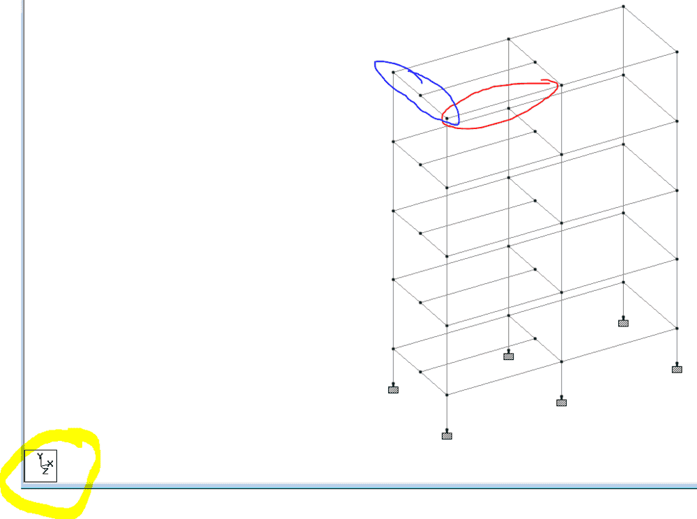

Anyone here familiar with StaadPro? In the software, Moment about x axis was defined as torsional moment.. While moment about z and y axes are bending moment... Why is it ?
Not applicable
The direction of x, y and a axes were shown in the highlighted part..
I think it is wrong. For red circled beam, i kinda agree that Moment about x-axis was defined as torsional moment.. While moment about z and y axes are bending moment...
But for blue circled beam, I think that Moment about z axis was defined as torsional moment.. While moment about x and y axes are bending moment...
Please correct me if I am wrong.
I have not used Staadpro, but I suspect that it uses both a global coordinate system (highlighted by you) and a local coordinate system for individual members of the frame, in which system the local x-axis is always along the axial length of the member. Thus , Mx moments are always torsional, regardless of the members location specified in the global coordinate system.
In structural analysis, the terms "bending" and "torsional" usually refer to transverse and axial moments respectively. These are essentially local definitions.
