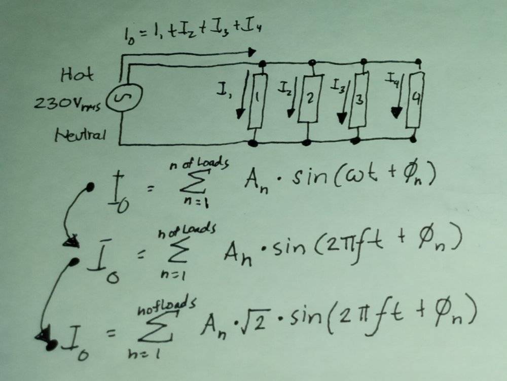

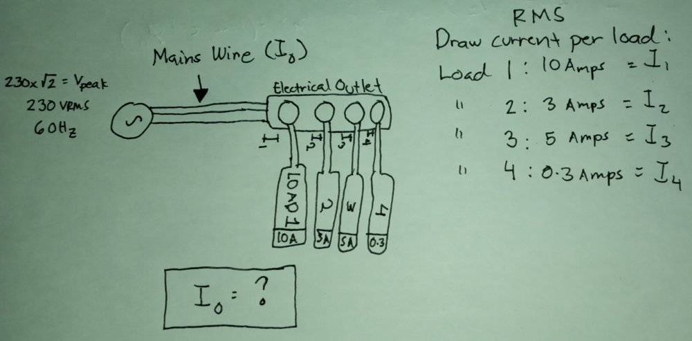

What would be the total current running through I_0 if there are loads connected to it?
I made this scenario where I am looking for the total current running through a wire (I_0).
I am also trying to model the current running through the wire (I_0) considering the harmonics contributed by the four loads.
But since Fourier stated that a complex waveform is the discrete sum of some waves (I_1, I_2, I_3, I_4), can I simply model the current through
I_0 with Fourier series?

Here is what I did:
I am looking for I_0 considering it that I_0 is a complex wave due to the harmonic current distortions caused by the non-linear loads (A_1, A_2, A_3, A_4).
Notice that I added a *sqrt(2) >> [computing the peak value from RMS] << in the equation as loads draw current shown in RMS values and I am trying to get the instantaneous value with the peak value in consideration.
Any concepts/laws/theories I can use in this modelling of mine?
What exactly do you mean by non-linear? Does it draw a different amount of current (or does the angle change) depending on the voltage?
If current magnitude and angle of each device is constant, then you could turn each one into a phasor (since the frequency is identical in all of them) and add them up as complex numbers, them convert that back to a some (time domain).
You mentioned about harmonics. None of your written equations take into account higher multiples of the frequency, though.

Kirchoff's Laws apply to both AC and DC. The answer to the OP is Kirchoff's Current Law.
@Tom.G gave it away in #6. If you work on the instantaneous basis, the difference between AC and DC vanishes.
@HAgdn , The sum of all currents at any node is zero. That means I0-I1-I2-I3-I4=0 at every instant, regardless of the waveform, regardless of how things vary with time, regardless of the nature of the loads, regardless of AC or DC or complex waveforms.

The formula I0-I1-I2-I3-I4=0 is always the same.
If your loads are resistors, you can just add 4 numbers to get I0.
If your loads contain resistors or inductors, but are still linear, you need to consider that phase lag or lead of the currents as well as the amplitude. The currents could cancel.
If your loads are not linear, for example a DC power supply without power factor correction, you will have to consider multiples of the mains frequency, and work out the amplitude and phase for all of them, before you can add up those currents.

What if I can determine the phase angle at which the individual currents are drawn?
I0(t) = Σ# of loadsn=1 An * √(2)* sin(2πf + Φn)
Where I can calculate the phase angle through time delay of the current with respect to the voltage:
Φn = 360° * f * Δt

The answer to question as stated is 18.3 A. If you want to deal with Fourier transforms, ask a different question.
